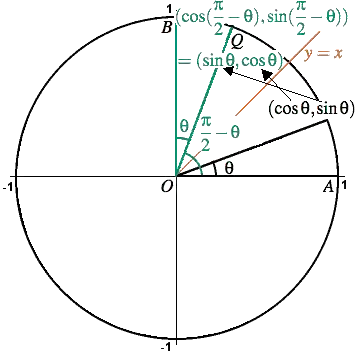

Yes $$\cos \theta=\sin(\frac{\pi}{2}\pm \theta)$$
always holds.
You can easily prove by trigonometric rules but you can also easily check by graphical observation and symmetry.
You could also prove in this way:
from
$$\cos \theta=\sin(\frac{\pi}{2}- \theta)$$
thus
$$\cos \theta=\cos -\theta=\sin(\frac{\pi}{2}+ \theta)$$
