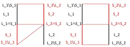

Round 1: Attack
"Team 1 uses its strengh ($L_1$) to attack the weakness ($S_2$) of another team": Form a triangle with $L_1$ and a vertex of $S_2$ (either $S_2\setminus L_2$ or $L_2 \cap S_2$). To keep this game, assume that $L_1$ is never an (S) side. We try to "encircle" $S_2$ with two (S) sides in order to apply lemma $\triangle$. There are $2\times 2=4$ possible choices of the (S) sides for these two triangles.

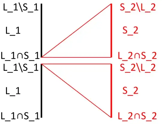

Case 1: Ideal case
Invoke lemma $\triangle$ and finish. Cas un ideal For the upper part of the figure, we assign $\color{red}{L_1\cap S_1 L_2\cap S_2}$ to be the (S) side for $\triangle L_1 L_2\cap S_2$ and $\color{red}{L_1\cap S_1 S_2\setminus L_2}$ to be the (S) side for $\triangle L_1 S_2\setminus L_2$. The lower part is similar.

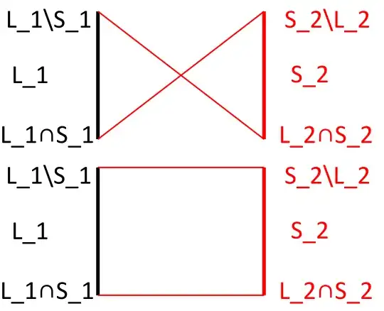

Case 2: X & Case 3: =
For these two cases, move to next round. Cas autres

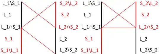

Round 2: Counterattack
Team 2 now do the same to team 1. The ideal cases are omitted to save ink.
Case 2: X
We focus on $\triangle L_2 S_1\cap L_1$. round22
Either apply
  • lemma $\star$ on $L_1\cap S_1$; or
  • lemma $\triangle$ on $\triangle L_1\cap S_1 L_2$
Case 3: =
We focus on $\triangle S_1 L_2\cap S_2$. round23
  • On the left half, $\color{red}{S_1\setminus L_1 L_2\cap S_2}$ is the (S) side for $\triangle S_1 L_2\cap S_2$. Apply lemma $\triangle$ to conclude.
  • On the right half, it's the only case left: $\color{red}{L_1\cap S_1 L_2\cap S_2}$ is the common (S) side for $\triangle L_1 L_2\cap S_2$ and $\triangle L_1\cap S_1 L_2$.
