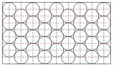

Consider the following diagram of a triangular packing:
circle-packing
If the circles have radius $r$, then each pair of horizontal red lines is a distance $r$ apart, and they're a distance $r$ from the edges. Each pair of vertical blue lines is a distance $r \sqrt 3$ apart, and they're still a distance $r$ from the edges.
So if you want the triangular packing to have $m$ circles in each column, and $n$ columns, then the rectangle must be at least $(2m+1) \cdot r$ units tall and $(2 + (n-1)\sqrt3) \cdot r$ units long. (Also, if the rectangle is only $2m \cdot r$ units tall, we can alternate columns with $m$ and $m-1$ circles.)
If the rectangle is $257 \times 157$ and the radius of a circle is $\sqrt{\frac{10}{\pi}}$, then:
  • If we make $257$ the vertical dimension, then the rectangle is a bit over $144 \cdot r$ units tall, and a bit over $(2 + 49\sqrt3) \cdot r$ units wide. So we can arrange the circles in $50$ columns that alternate between $72$ and $71$ circles, for $25 \cdot 72 + 25 \cdot 71 = 3575$ circles.
  • If we make $157$ the vertical dimension, then the rectangle is a bit over $87 \cdot r$ units tall, and a bit over $(2 + 82\sqrt3) \cdot r$ units wide. So we can arrange the circles in $83$ columns that have $43$ circles each, for $3569$ circles.
We pick the first option, which gave us the greater value.
