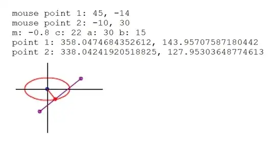

I used Hamed's answer. However, it doesn't appear to be working for me. I was hoping someone could tell me what I'm doing wrong. The $x$ values are coming out much higher than they should, and it often determines that there aren't real roots when there are. I'm not seeing the difference between my implementation and the solution. I'm just curious if I implemented it incorrectly, the equation is wrong or maybe there is something else I'm missing?
Thanks in advance, I appreciate any assistance I can get as I've hit a road block at this point.
Edit: $a$ and $b$ are of arbitrary size, $a$ can be larger than $b$ and vice versa. the ellipse is at the origin $(0,0)$ and the line is a line segment which is defined by end points. you'll also notice I multiplied things by themselves rather than use the built in function for squaring something, as I've read it's expensive in terms of computing power.
Edit: here is an example
example 1

  • "to find the point perpendicular to ..". What do you mean by a point being perpendicular to something else? – stressed out Nov 24 '17 at 01:50
    that solution didn't work, so not really that important... but what i mean was draw a line from the center of the ellipse to the line being tested. with the line from the center being perpendicular to the line given. This worked well for everything except some situations where the line barely contacts the perimeter of the ellipse. – Hussein Sabbagh Nov 24 '17 at 02:33
