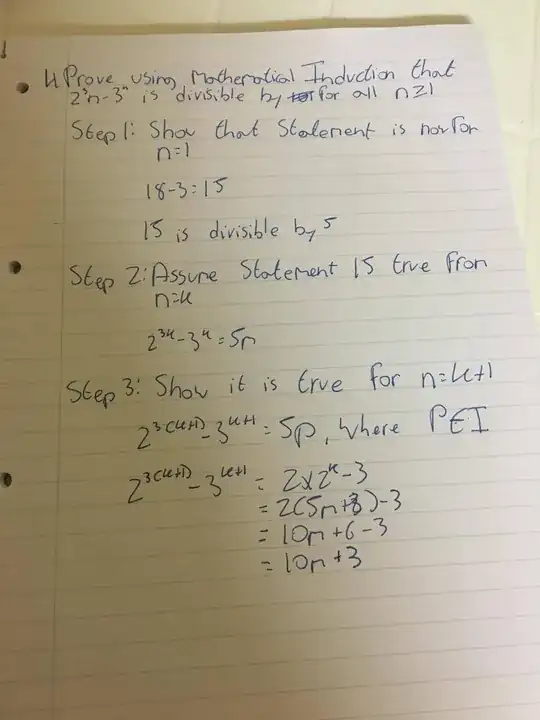

I did most of it but I stuck here I attached my working tell me if I did correct or not thanks
My working: My working
EDITED: I wrote the notes as TEX Prove using induction that $2^{3n} - 3^n \mod{5} = 0$.
Statement is true for $n = 1$: $$2^{3 * 1} - 3^1 = 2^3 - 3 = 8 - 3 = 5$$ $$5 \mod{5} = 0$$
Now for $n = p$ and $n = p + 1$: $$2^{3(k+1)} - 3{k + 1} = 2 * 2^p - 3$$ $$=2(5n + 3) - 3=10n + 6 - 3 = 10n+3$$

Hint: $2^{3(n+1)}-3^{n+1} = 8(2^{3n}-3^{n})+3^n(8-3).$

we have $$2^{3n}-3^{n}=8^n-3^n\equiv 3^n-3^n\equiv 0\mod 5$$
We first show for the $n=1$ case:
$2^3-3 = 8-3 = 5$
which is clearly divisible by 5. Next is the inductive step where we assume
$2^{3n} - 3^n=5m $ for some integer $m$.
We can rewrite this as
$2^{3n}=5m+3^n$.
Now we want to prove that $2^{3(n+1)}-3^{n+1}$ is divisible by 5. We first can simplify this a bit:
$2^{3(n+1)}-3^{n+1} = 2^{3n+3}-3^{n+1}=2^3\cdot2^{3n}-3\cdot 3^n$.
We can now make the substitution from the previous statement to write this as
$2^3(5m+3^n)-3\cdot 3^n=5(8m)+8\cdot 3^n-3\cdot 3^n = 5(8m)+5\cdot3^n=5(8m+3^n)$
which is clearly divisible by 5 and proves the statement.
By I.H. we have $2^{3n}-3^{n}=5k$ for some integer $k$ and thus $2^{3n}=3^{n}+5k$.
Now we have:
$$2^{3(n+1)}-3^{n+1} = 8\cdot 2^{3n}-3^{n+1}= 8(3^{n}+5k)-3^{n+1} = 3^n(8-3)+40k = 5\cdot (3^n+8k)$$
and we are done.

It's hard to read your handwriting but it looks like you have the right idea but were sloppy in your execution and made so distributive error.
Assume if $n=k$ then statement is true and
$2^{3k} - 3^k = 5P$ for some integer $P$. (Always a good idea to specify what a variable is whenever you introduce it.)
$2^{3k+1} -3^{k+1}= 2*2^{3k} - 3$.
Theres two errors here: $2^{3(k+1)} \ne 2^{3k+1}$ and ... why did the $3^{k+1}$ turn into a $3$.
You should have:
$2^{3(k+1)} - 3^{k+1} = 2^{3k + 3} - 3^{k+1} = 8*2^{3k} - 3*3^{k}$
Can you go from there?
$8*2^{3k} - 3*3^{k} = 5*2^{3k} + 3*2^{3k} - 3*3^k = 5*2^{3k} + 3(2^{3k} - 3^k) = 5*2^{3k} + 3(5P) = 5(2^{3k} + 3P)$
