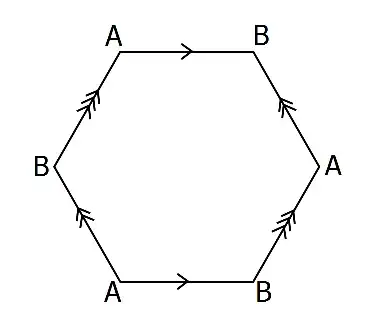

Here's an example of a hexagon that works:
The vertices labeled A are all identified with each other, as are the vertices labeled B. Since the angles all measure $120^\circ$, each set of three angles fits together to make a smooth flat surface. (The resulting surface is homeomorphic to the torus, as it must be because it has a flat metric. It's an interesting exercise to prove this directly by cutting and pasting.)
