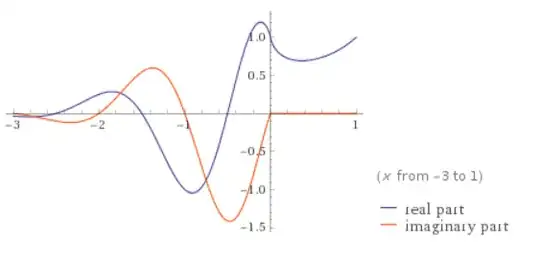

                                                                        Figure 1
This is the graph of $f(x)=x^x$, with its real parts and its imaginary parts shown, and similarly:

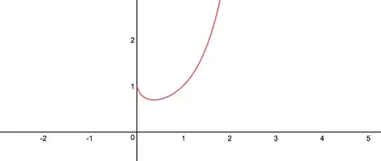

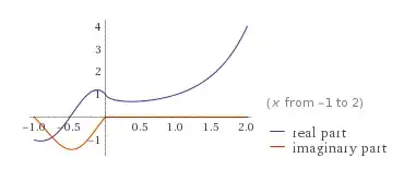

                                                                       Figure 2
so is this, except here obviously only the real part is shown, or is it? I understand that for the values of $\lbrace{x:x\notin\mathbb Z,x<0\rbrace}$, $f(x)$ will have an imaginary part, as there will be some rather severe negative roots in here. Therefore, if we were only plotting the values of $\lbrace{f(x):f(x)\in\mathbb R\rbrace}$, the graph would have discontinuity everywhere besides the isolated points such that $\lbrace{x:x\in\mathbb Z,x<0\rbrace}$ similar to Firgure 1, so why does the graph in Figure 2 not continue for any values of $x < 0$?

  • $x^x$ has no sensible real value for any $x<0,x\not\in\Bbb Z$. There are no discontinuities there because ${f(x)\mid f(x)\in\Bbb R}$ will have huge gaps below zero. For a beginning, how would you compute $x^x$ for say $x=-\pi$? (I have not looked at the video but I guess something like this is done there). You will not find a real value. – M. Winter Nov 02 '17 at 09:25
  • Why is this a good enough reason to restrict the domain of the function to $\lbrace{ x:x\in\mathbb R,x>0\rbrace}$, though? @M.Winter – joshuaheckroodt Nov 02 '17 at 09:27
  • Maybe two reasons: 1. because you only want to deal with real numbers, 2. there is no preferred answer to what $x^x$ is when $x<0,x\not\in\Bbb Z$. It is the same with $\sqrt x$. You should never apply it to negative numbers, and Yes I say $\sqrt{-1}=i$ is mostly not a good way to do it. But of course you can extend it to negatives. Noone says that defining it for $x>0$ is the only right thing to do. Do what you need for your specific application. (See my answer here) – M. Winter Nov 02 '17 at 09:28
Your Figure 1 doesn't go far enough. It's true that there is no imaginary part at $x=-1$, but there is an imaginary part for $-2<x<-1$ (and $-3<x<-2$ and so on). So if you just plotted the real-valued graph it should have some isolated points at $x=-k$ for $k\in\mathbb N$, but it wouldn't be defined on any interval below $0$.
  • This is something that I've just considered and added to the question, but it still doesn't necessarily explain why we ignore the values of $f(x)$ where $x<0$, since the points where $x\in\mathbb Z,x<0$ are still defined. – joshuaheckroodt Nov 02 '17 at 09:24
    You can include those points if you like. But computer graph plotters don't tend to handle isolated points properly because if you're plotting a bunch of points and joining them up, at best you don't have anything to join them to, but normally you'll miss them completely either because you don't try that exact value or because of floating-point arithmetic issues. – Especially Lime Nov 02 '17 at 09:29
As other answers already covered, yes, you could include isolated points at negative integers, but usually, we don't like to mix discrete and continuous plotting, and in terms of continuous functions in real numbers, this one is undefined for negative numbers.
