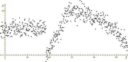

Suppose we have (an interval of) a time series of measurements:
plot of raw (simulated) data
We assume it can be explained as a "simple" underlying signal overlaid by noise. I'm interested in finding a good algorithm to estimate the value of the simple signal at a given point in time -- primarily for the purpose of displaying it to human users who know, more or less, how to interpret the signal but would be distracted by the noise.

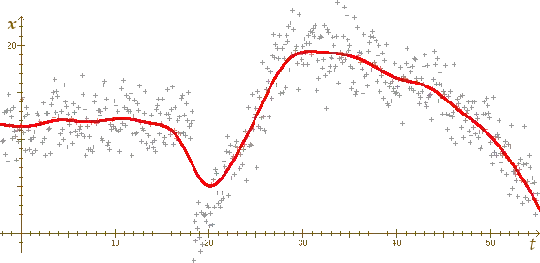

For a human observer of the plot it looks very clearly like the underlying signal has a jump discontinuity at about $t=18$. But that's a problem for automatic noise removal, because the techniques I know are all predicated of a "nice" underlying signal meaning a "smooth" one. A typical anti-noise filter would be something like colvolving with a Gaussian kernel:
plot of Gaussian smoothing

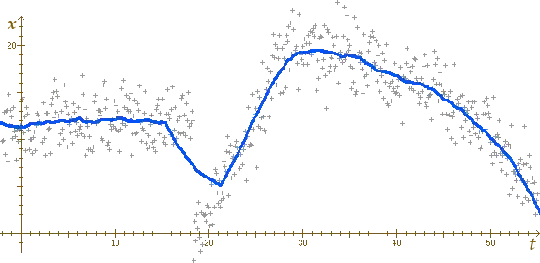

which completely fails to convey that the left slope of the dip is any different from the right one. My current solution is to use a "naive" rolling average (i.e. convolution with a square kernel):
plot of square smoothing
whose benefit (aside from simplicity) is that at least the sharp bends in the signal estimate alert the viewer that something fishy is going on. But it takes quite some training for the viewer to know what fishy thing this pattern indicates. And it is still a tricky business to pinpoint when the abrupt change happened, which is sometimes important in my application.
The widths of the convolution kernels in the two examples above were chosen to give about the same smoothing of the pure noise (since I've cheated and actually constructed the sample data I'm showing as the sum of a crisp deliberate signal and some explicit noise). If we make them narrower, we can get the estimate to show that there's an abrupt change going on, but then they don't remove all of the noise:
