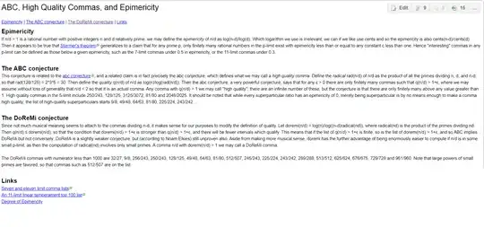

Irrelevant to the main question (For those who are interested in the connection between music theory and powers of primes): Years ago when I was writing this answer, I did not know about its connection with music theory. This morning I received a notification for an up-vote to this question (That's why I added this information). 3 or 4 months ago, I got information about the relationship between music theory (Superparticular ratios) and prime powers $2$, $3$, etc.; the links to which I will briefly share here:
  1. Størmer's theorem
  2. ABC, High Quality Commas, and Epimericity (The original link has expired)
  3. A Weaker Version of the ABC Conjecture
Just read the first link (I mean Størmer's theorem), to understand the connection between music theory (Superparticular ratios and ...) and the powers of prime numbers through Pell equations.
Also, you can see the contents of the link in the "Internet Web Archive" in the image below (just to be sure, if this link becomes unavailable in the future): enter image description here
