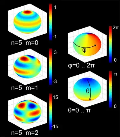

Now the sphere comes from the idea that, SH functions, use the Legendre polynomials (but Legendre polynomials are 1D functions), and the specification of spherical harmonics is a function value for every $\phi \theta$. There is no "sphere" per se.. it's like if you say "there is a value for every point on the unit circle", it means you trace a circle around the origin and give each point a value.
What is meant is every point on a unit sphere has a numeric value. If we associate a color to every point on the sphere, you get a visualization like this:
viz sh colors
This page shows a visualization where the values of the SH function are used to MORPH THE SPHERE (which is part of what was confusing me earlier). But just because a function has values for every point on the sphere doesn't mean there is a sphere.

$\theta$ and $\phi$ the coordinates of a spherical surface. They are similar to latitude ($\theta$) and longitude ($\phi$) except that $\theta$ goes from $0$ to $\pi$ and $\phi$ goes from $0$ to $2\pi$. Each harmonic has a value at every point, for example $Y_1^{-1}(\theta,\phi)=\frac{1}{2}\sqrt{\frac{3}{2\pi}}\sin(\theta)e^{-i\phi}$. Given the coordinates you can calculate the value. The orthogonality is because if you integrate the product of any two different harmonics over the surface of the sphere, you get $0$.
