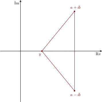

Proof. Write $x = a + ib$ with $a,b\in\text{Re}(X)$, given explicitly by $a := \text{Re}(x)$ and $b := \text{Im}(x)$. The result follows from a simple application of the triangle inequality:
triangle inequality
Indeed, we have \begin{align} \hspace{-35mm}2\lVert x - \text{Re}(x)\rVert \: = \: \lVert 2ib\rVert \: &= \: \lVert (a + ib) - y \: + \: y - (a - ib)\rVert\\[1ex] &\leq \: \lVert (a + ib) - y \rVert + \lVert y - (a - ib)\rVert\\[1ex] &= \: \lVert (a + ib) - y\rVert + \lVert (a - ib) - y\rVert\\[1ex] &= \: \lVert (a + ib) - y\rVert + \big\lVert \, \overline{(a + ib) - y} \, \big\rVert\tag*{(since $a,b,y\in\text{Re}(X)$)}\\[1ex] &= \: 2\lVert (a + ib) - y\rVert\tag*{(since $\bar{\ }\,$ is isometric)}\\[1ex] &= \: 2\lVert x - y\rVert.\tag*{$\blacksquare$} \end{align}
