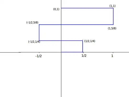

This answer is wrong, as pointed out by Wen. I won't delete it: maybe someone will find it useful to create a working counterexample
I think this should work as a counterexample.
Take $a=0$, $b=7$. We will define $f$ piecewisely.
For $t\in[0,1]$, $\ \ f(t)=(\frac{t}{2},0) $;
for $t\in[1,2]$, $\ \ f(t)=(\frac{1}{2},\frac{t-1}{4})$;
for $t\in[2,3]$, $\ \ f(t)=(\frac{1}{2}-(t-2),\frac{1}{4})$;
for $t\in[3,4]$ $\ \ f(t)=(-\frac{1}{2},\frac{1}{4}+\frac{3}{8}(t-3))$;
for $t\in[4,5]$, $\ \ f(t)=(-\frac{1}{2}+\frac{3}{2}(t-4),\frac{5}{8})$;
for $t\in[5,6]$, $\ \ f(t)=(1,\frac{5}{8}+\frac{3}{8}(t-5))$;
for $t\in[6,7]$, $\ \ f(t)=(1-(t-6),1)$.
Since it is possible that I made some mistake in the parametrization, the idea is the following:
Start from $(0,0)$; go along the x-axis to the point $(\frac{1}{2},0)$; go up to the point $(\frac{1}{2},\frac{1}{4})$; now "turn back" to the point $(-\frac{1}{2},\frac{1}{4})$; now go up to the point $(-\frac{1}{2},\frac{5}{8})$. At this point you are above the points with y-coordinate $\frac{1}{2}$. To add $\frac{3}{8}$ vertically, without having two points $t_1,t_2$ s.t. $f(t_1)-f(t_2)=(0,\frac{1}{2})$, you need to go back "beyond" $\frac{1}{2}$ in the x-direction, then you can reach the points with y-coordinate 1 "safely".

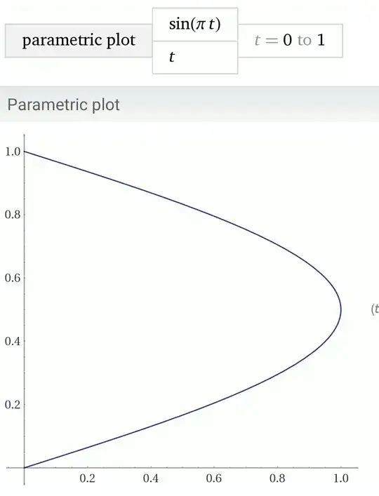

Let $\gamma\colon{\rm I}\to\mathbb R^2$ be the smooth function $$\gamma(t) = (\sin(\pi t), t).$$ Here is the plot of $\gamma$: plot of $\gamma$
Define $F, G\colon {\rm I}^2\to\mathbb R^2$ (note the same dimension) by $$F(x,y) = \alpha(x) - \alpha(y)$$ and $$G(x,y) = \gamma(x) - \gamma(y).$$
We have that $F$ and $G$ are homotopic since it assumes values on $\mathbb R^2$ (we can take the linear homotopy). Therefore, $\deg(F,q) = \deg(G,q)$.
Let's calculate $\deg(G,q)$. First, we have to verify that $q$ is in fact a regular value for $G$ to then apply the degree formula. We are going to take a look at the set $G^{-1}(q)$.. with some straight forward calculations, we can see that $$G(x,y) = q \Leftrightarrow \left\{ \begin{matrix} x = k + 3/4 \\ y = k + 1/4 \end{matrix}\right. , k\in\mathbb Z$$ and $k=0$ gives the solution $(x,y)=(3/4,1/4)$, that lies in ${\rm I}^2$. So $G^{-1}(q) = \{(3/4,1/4)\}$.
Note that $$G'(x,y) = \begin{bmatrix} \pi\cos(\pi x) & -\pi\cos(\pi y) \\ 1 & -1 \end{bmatrix},$$ thus $$\det G'(x,y) = -\pi(\cos(\pi x) - \cos(\pi y))$$ and $$\det G'(3/4,1/4) = \pi\sqrt{2} > 0.$$ Therefore, \begin{equation*} \begin{split} \deg(G,q) & = \sum_{(x,y)\in G^{-1}(q)} {\rm sign} \det G'(x,y) \\ & = {\rm sign} \det G'(3/4,1/4) \\ & = {\rm sign} \pi\sqrt{2} \\ & = 1. \end{split} \end{equation*}
Since $\deg(F,q) = \deg(G,q) = 1 \neq 0$, we conclude that there exists some $(x_0,y_0)\in{\rm I}^2$ such that $F(x_0,y_0) = q$, i.e., $$\alpha(x_0) - \alpha(y_0) = (0,1/2).$$
