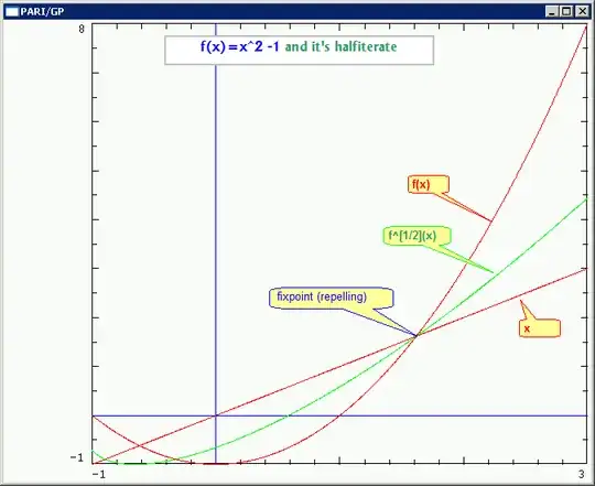

Your function has a fixpoint in the positive numbers where also the tangent (derivative of $f(x)$) is positive, although it is not attracting but repelling. Anyway, a recentering of the polynomial on $f(x)$ allows a polynomial in $g(x)$ without constant term.
From this a powerseries $g_{05}(x)$ representing the halfiterate of $g(x)$ can be constructed.
In this situation of asking only for the functional squareroot (and not for the full fractional iteration to any noninteger iteration-height) the extremely simple "Newton-algorithm" for finding the squareroot of a number can be involved - of course after adaption for finding the squareroot of a formal powerseries. This looks quick&dirty, but gives a correct solution.
I used the software Pari/GP for this.
Definition of the function:
f(x)  = x^2 - 1
                 fi(x) = sqrt(1+x)   \\ the inverse (not needed here)
Define a new function whose power series is centered around the attracting fixpoint (this is $t_0$ here):
     t0=(1+sqrt(5))/2  \\ fixpoint t0  at 1.61... (repelling)
     t1=(1-sqrt(5))/2  \\ fixpoint t1  at -0.61... (attracting) not needed here
g(x) = x^2+2*t0*x       \\ = f(x+t0)-t0  function f() recentered around t0
                    gi(x)= sqrt(x+t0^2)-t0  \\ inverse of g(x), not needed here
Iterative Newton-algorithm for finding the squareroot of a number, here adapted for formal powerseries:
\\ initializing newton-algo for finding (functional-) squareroot
\ps 64            \\ precision of involved powerseries (64 terms)
g05= x + O(x^64)  \\ initalizing the power series for halfiterate of g(x)
for(k=1,40,g05=(g(serreverse(g05))+g05)/2) \\ iterate(40 times for precis.)
        \\ in g05 is now a well approximated formal powerseries
Make a proper functional expression out of it for Pari/GP-calls:
hg(w) = subst(Pol(g05),x,w)  \\ halfiterate of g(x)
hf(x) = hg(x-t0)+t0          \\ halfiterate of f(x) by recentring hg(x)
Testing:
\\ test some values
x0 = 0.2
   x05= hf(x0)
   x1 = hf(x05)
\\ show comparision
[x0,x05,x1;x0,x0,f(x0)]
\\ output:
\\  x0            x05              x1
[0.200000000000 -0.459584198682 -0.960000001849]  by hg() resp hf()
[0.200000000000 --------------- -0.960000000000]  by f(x)
Make a plot:
ploth(x=-1,3,[x,hf(x),f(x)])
(Plot edited using excel for labeling)
