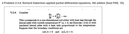

CAS seems to be still not too advanced in solving some basic PDE problems that we can solve easily by hand. These below are some HW's problems, from textbooks, which can be solved by hand but not by Mathematica at this time. Using 11.1.1.
Mathematica graphics
ClearAll[u,t,k,x,L,a];
pde=D[u[x,t],t]==k D[u[x,t],{x,2}]-a u[x,t];
bc={u[0,t]==0,u[L,t]==0}
ic=u[x,0]==f[x];
NumericQ[L]=True;
sol=DSolve[{pde,bc,ic},u[x,t],{x,t}]

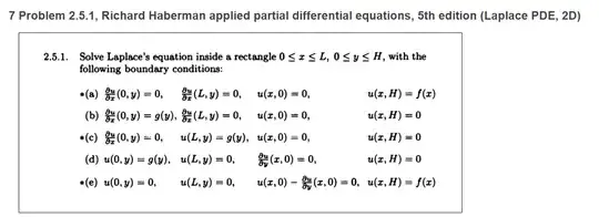

ClearAll[u,t,k,x,L,H,g];
pde=D[u[x,y],{x,2}]+D[u[x,y],{y,2}]==0;
bc={Derivative[1,0][u][0,y]==0,u[L,y]==g[y],u[x,0]==0,u[x,H]==0};
sol=DSolve[{pde,bc},u[x,y],{x,y},Assumptions->{0<=x<=L&&0<=y<=H}]
part (d)
ClearAll[u,t,k,x,L,H,g,f];
bc={u[0,y]==0,u[L,y]==0,Derivative[0,1][u][x,0]==0,u[x,H]==0};
part (e)
bc={u[0,y]==0,u[L,y]==0,u[x,0]-Derivative[0,1][u][x,0]==0,u[x,H]==f[x]};

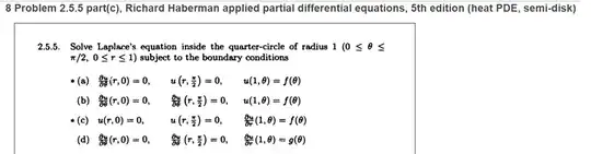

part (c)
ClearAll[u,theta,r];
pde=D[u[r,theta],{r,2}]+1/r  D[u[r,theta],r]1/r^2 D[u[r,theta],{theta,2}]==0;
bc={ Derivative[1, 0][u][1, theta] == f[theta],u[r,Pi/2] == 0,u[r,0]==0};
sol=DSolve[{pde,bc},u[r,theta],{r,theta},Assumptions->{0<=r<=1&& 0<=theta<=Pi/2}]

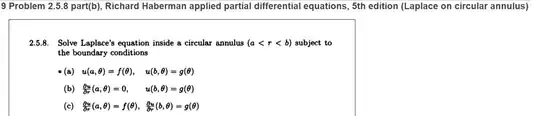

part (b)
bc={Derivative[1,0][u][a,theta]==0,u[b,theta]==g[theta]};
sol=DSolve[{pde,bc},u[r,theta],{r,theta},Assumptions->a<r<=b]

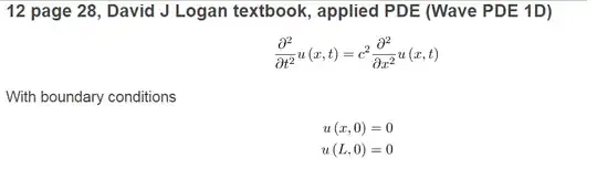

ClearAll[u,t,x,L,c];
pde=D[u[x,t],{t,2}]==c^2 D[u[x,t],{x,2}]
bc={u[0,t]==0,u[L,t]==0};
sol=DSolve[{pde,bc},u[x,t],{x,t},Assumptions->{L>0}]

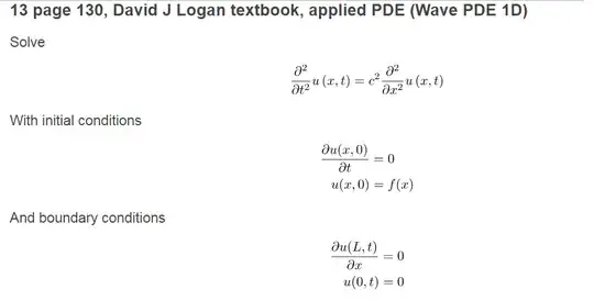

ClearAll[u,t,x,L,c,f];
bc={u[0,t]==0,Derivative[1,0][u][L,t]==0};
ic={Derivative[0,1][u][x,0]==0,u[x,0]==f[x]};
sol=DSolve[{pde,bc,ic},u[x,t],{x,t},Assumptions->{0<=x<=L}]

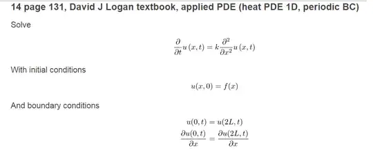

ClearAll[u,t,x,L,c,f,k];
bc={u[0,t]==u[2 L,t],Derivative[1,0][u][0,t]==Derivative[1,0][u][2 L,t]};
ic={u[x,0]==f[x]};
sol=DSolve[{pde,bc,ic},u[x,t],{x,t},Assumptions->{0<=x<=2 L}]

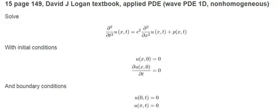

ClearAll[u,t,x,c];
bc={u[0,t]==0,u[Pi,t]==0};
ic={u[x,0]==0,Derivative[0,1][u][x,0]==0};

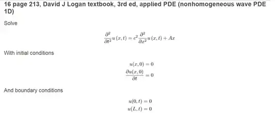

ClearAll[u,t,x,c,A,L];
pde=D[u[x,t],{t,2}]==c^2 D[u[x,t],{x,2}]+A x
NumericQ[L]=True;(*this had no effect*)

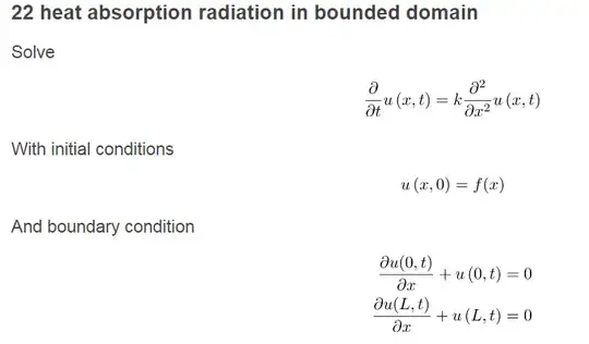

ClearAll[u,t,x,k,L,f];
pde=D[u[x,t],t]==k D[u[x,t],{x,2}];
bc={Derivative[1,0][u][0,t]+u[0,t]==0,Derivative[1,0][u][L,t]+u[L,t]==0};
ic=u[x,0]==f[x];
NumericQ[L]=True;(*adding this had no effect*)
sol=DSolve[{pde,bc,ic},u[x,t],{x,t},Assumptions->{t>=0,k>0,x>=0,x<=L}]

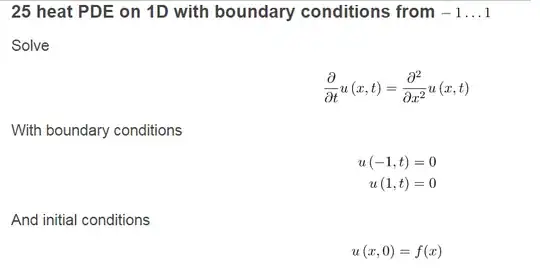

ClearAll[u,t,x,f];
pde=D[u[x,t],{t,1}]==D[u[x,t],{x,2}]
ic=u[x,0]==f[x]
bc={u[-1,t]==0,u[1,t]==0};
