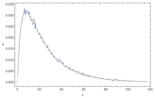

Quick Monte Carlo check
  • against theoretical solution derived above when $a =2$, $b = 3$, $\alpha = 4$, and $\beta = 1.1$
Looks fine :)

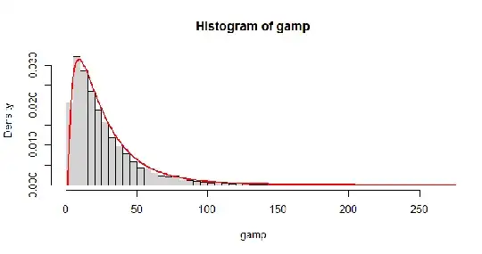

Another Monte-Carlo check confirms @wolfies nice result above,
GammaProductPlot
Plus an integral on the pdf confirms the accuracy of it to be the correct density. After integrating in R we obtain,
integrate(gamprod,lower = 0.,upper = Inf,ax = 2,bx = 3,ay = 4,by = 1.1) 1 with absolute error < 6.8e-05
