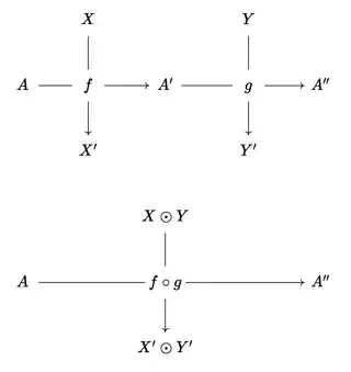

  • for every horizontally-congruent pair of crossed morphisms $f, g$ as on the top, a horizontal composite $f \circ g$ as on the bottom:
horizontal composition

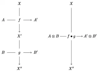

  • for every vertically-congruent pair of crossed morphisms $f, g$ as on the left, a vertical composite $f \bullet g$ as on the right:
vertical composition
