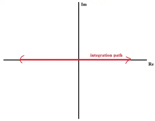

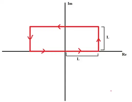

It appears this question is nearly four years old, but I'll answer it anyway for future reference. As you know, if we want to evaluate the Fourier transform of the function $f:x\mapsto \operatorname{sech}(\pi x)$ we need to compute the integral $$\mathcal{F}(f)(\xi)=\int_{\mathbb{R}}\operatorname{sech}(\pi x)e^{-2\pi i\xi x}\mathrm{d}x$$ In the complex plane this looks like this: enter image description here To appeal to the Residue Theorem, we think of another rectangular contour $$R(L)=R_1(L)\cup R_2(L)\cup R_3(L)\cup R_4(L)$$ Using $$R_1(L)=\{z\in\mathbb{C}:\operatorname{Im}z=0\text{ and }|z|<L\}$$ $$R_2(L)=\{z\in\mathbb{C}:\operatorname{Re}(z)=L\text{ and }0\leq\operatorname{Im}z\leq L\}$$ $$R_3(L)=\{z\in\mathbb{C}:\operatorname{Im}z=L\text{ and }-L\leq\operatorname{Re}z\leq L\}$$ $$R_4(L)=\{z\in\mathbb{C}:\operatorname{Re}(z)=-L\text{ and }0\leq\operatorname{Im}z\leq L\}$$ Oriented counterclockwise. In the complex plane this looks as such: enter image description here The trick is, if we can show that as we take $L\to\infty$, that the contribution to the integral from the parts of the contour off the real line vanishes, then we can say $$\lim_{L\to\infty}\oint\limits_{R(L)}\operatorname{sech}(\pi z)e^{-2\pi i\xi z}\mathrm{d}z=\int_{\mathbb{R}}\operatorname{sech}(\pi x)e^{-2\pi i\xi x}\mathrm{d}x$$ Once we've done this, we recall that the singularities of $f$ in the upper half plane occur at $$i\left(n+\frac{1}{2}\right)~~~~n\in\mathbb{N}_0$$ So $$\lim_{L\to\infty}\oint\limits_{R(L)}\operatorname{sech}(\pi z)e^{-2\pi i\xi z}\mathrm{d}z=2\pi i\sum_{n=0}^\infty \operatorname{Res}\left(f,i\left(n+\frac{1}{2}\right)\right)$$ I won't detail all of the computations here, but hopefully this is a good outline of the overall method.
