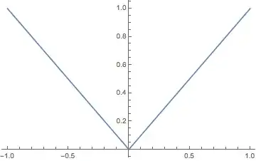

Short answer: We want a function which is differentiable everywhere.
After a concept is proposed, we will do anything we want on $it$ (so poor $it$ is T_T), like plus, minus, multiplication, integral, differentiation, and so on. Therefore, it would be better if $it$ can be done by these operations.
As we can see that the function $f(x)=|x|$ is not differentiable at $x=0$. You may image that it is not smooth at $x=0$. Therefore, there are nuisances when we consider some thing at this point!

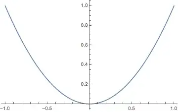

However, the function $f(x)=x^2$ is smooth enough everywhere! enter image description here
Generally speaking, a polynomial will differentiable everywhere on $\mathbb{R}$.
Yes, you can take $f(x)=x^4$ or $f(x)=x^6$, but it is not necessary.
Also, another benefit is that the square function punishes observations far away from the expected value much more, than the absolute value function does. So when we minimize with respect to square function instead of the absolute value function, we consider observations far away as important. The farther away, the more weight is has.
