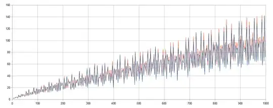

Addendum: As in Greg Martins answer $$k(n)\approx k'(n)=\frac{3}{4}\frac{n}{\ln n} \displaystyle \prod_{\substack{p\equiv1\pmod 4 \\ p\mid n}} \frac{p-1} {p-2}\prod_{\substack{p\equiv3\pmod 4 \\ p\mid n}} \frac {p-1}p$$ which gives the diagram enter image description here where $k$ is the blue curve and $k'$ is the red curve.

    Let $k(n)$ be the number of of pairs $(a,b)$ with $a < b$ for which this holds. Here is a histogram of $\frac{k(n) \cdot\log n}{n}$ for $n \le 20,001$ to illustrate this.. https://imagizer.imageshack.us/v2/540x332q90/924/OrMPJK.png – Hans Engler Aug 08 '17 at 17:02

Here are some heuristics. As Hans Engler defines, let $k(n)$ be the number of pairs $(a,b)$ with $a<b$ for which $a+b=n$ and $a^2+b^2$ is prime. In other words, $$ k(n) = \#\{ 1\le a < \tfrac n2 \colon a^2 + (n-a)^2 = 2a^2 - 2an + n^2 \text{ is prime} \}. $$ Ignoring issues of uniformity in $n$, the Bateman–Horn conjecture predicts that the number of prime values of an irreducible polynomial $f(a)$ up to $x$ is asymptotic to $$ \frac x{\log x} \prod_p \bigg( 1-\frac1p \bigg)^{-1} \bigg( 1-\frac{\sigma(p)}p \bigg), $$ where $\log$ denotes the natural logarithm and $$ \sigma(p) = \#\{ 1\le t\le p\colon f(t) \equiv 0 \pmod p \}. $$
We now calculate $\sigma(p)$ for $f(a) = 2a^2 - 2an + n^2$. Note that the discriminant of $f$ is $(-2n)^2 - 4\cdot2n^2 = -4n^2$. Therefore if $p$ does not divide $-4n^2$, the number of solutions is given by the Legendre symbol $$ \sigma(p) = 1 + \bigg (\frac{-4n^2}p\bigg) = 1 + \bigg (\frac{-1}p\bigg) = \begin{cases} 2, &\text{if } p\equiv1\pmod 4, \\ 0, &\text{if } p\equiv3\pmod 4. \end{cases} $$ Furthermore, we can check by hand that if $p=2$ then $\sigma(p)=0$, while if $p$ divides $n$ then $\sigma(p)=1$. Therefore our prediction becomes $$ k(n) \approx \frac{n/2}{\log(n/2)} \cdot 2 \prod_{\substack{p\equiv1\pmod 4 \\ p\nmid n}} \frac{p-2}{p-1} \prod_{\substack{p\equiv3\pmod 4 \\ p\nmid n}} \frac p{p-1}. $$ (We're abusing notation: those two products don't individually converge, but their product converges when the primes are taken in their natural order.) In principle that constant could be cleverly evaluated to several decimal places. But for the purposes of experiment, perhaps it's valuable to note that $k(n)$ should be approximately $n/\log n$, times some universal constant, times $$ \prod_{\substack{p\equiv1\pmod 4 \\ p\mid n}} \frac{p-1} {p-2}\prod_{\substack{p\equiv3\pmod 4 \\ p\mid n}} \frac {p-1}p; $$ and so the data can be normalized by that function of $n$ to test for consistency.
