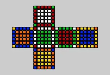

Algorithm Michael Z. R. Gottlieb 2008
F R' B' D2 · F' B2 · D2 L D' F R' F' U' F' R' B R U2 TF TR' TB' TD2 · TF' TB2 · TD2 TL TD' TF TR' TF' TU' TF' TR' TB TR TU2 T3B T3L T3U2 T3B2 T3L' T3B T3U T3L' T3U2 T3L' T3B' (47 btm)
First
part1

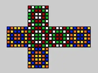

Second
part2

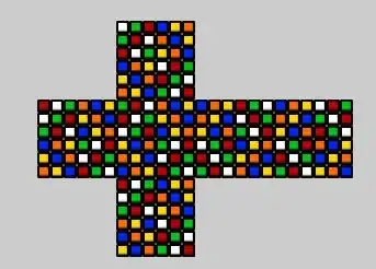

Final
part3
