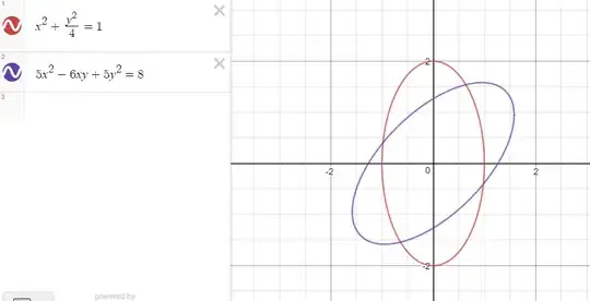

So I'm trying to find the intersections of the equations $$\ {x^2\over 1^2} + {y^2\over 2^2} = 1 $$ $$5x^2 - 6xy + 5y^2 = 8 $$ Both of the equations represent an ellipse, with the first ellipse being a vertical ellipse and the second ellipse being first one rotated 315 degrees counterclockwise. I tried using the elimination method to solve this problem but I don't think I can use it because of the xy term in the second equation. I found this post but I am not sure if this would be useful to help me solve this. My question is what do I need to do in order to find the intersections of these two ellipses? Am I able to continue using the elimination method? Do I have to use a different approach? Or is the post somewhat useful to solve this problem? Edit: Here is a graph of the two equations
draw some pictures, it is not obvious to me that they intersect at all (meaning real numbers only) – Will Jagy Jul 24 '17 at 19:29
I have already graphed them out on Desmos, but I'm trying to find the exact answer mathematically – Eliot Jul 24 '17 at 19:32
1https://www.desmos.com/calculator/2ldua2zwfz @WillJagy – Donald Splutterwit Jul 24 '17 at 19:32

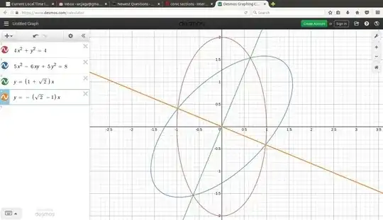

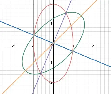

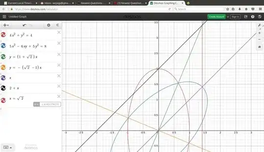

The interesting part is that the ellipses are congruent, and the intersection points are located at rotation half of the given $45^\circ.$ Drawing a certain rhombus tells us that the intersections in the first quadrant occur on the line $y = (\sqrt 2 + 1) x,$ so that $y^2 = (3 + \sqrt 8)x^2.$ Plug that into $4x^2 + y^2 = 4,$ I get $$ x^2 = \frac{4(7 - \sqrt 8)}{41}, \; \; \; y^2 = \frac{4(13 + 4 \sqrt 8)}{41}, $$ $$ x^2 = \frac{28 - 8 \sqrt 2}{41}, \; \; \; y^2 = \frac{52 + 32 \sqrt 2}{41}. $$ Then $4x^2 + y^2 = (112 + 52)/ 41 = 164/41 = 4$
The other pair of intersections are on the line with negative reciprocal slope, $y = -(\sqrt 2 - 1) x,$ so that $y^2 = (3 - \sqrt 8)x^2.$ This time $$ x^2 = \frac{28 + 8 \sqrt 2}{41}, \; \; \; y^2 = \frac{52 - 32 \sqrt 2}{41}. $$

1I had not spotted that $y=(1+\pm \sqrt{2})x$. Your's is now the best solution. $\ddot \smile$. – Donald Splutterwit Jul 25 '17 at 18:57

@Eliot in case it matters, I took out the trigonometry in my answer and put in slopes of lines instead. And a nice picture. – Will Jagy Jul 25 '17 at 17:22
@Will Jagy no it doesn't matter. I was actually able to understand the trigonometry very well and you had a great answer. But thank you for the help, your new answer is also really useful. – Eliot Jul 26 '17 at 18:04
