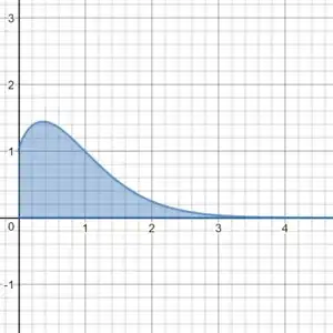

I'm trying to find a closed form for this integral:$$\int_{0}^{\infty}x^{-x}dx$$
Here's the integrand graph:
Clearly it is convergent. My attempt is to obtain a closed form for the area under the curve. Is this possible?
