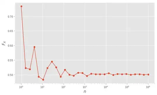

Is there a simpler probabilistic argument in this case? In the meantime, I confirmed the limit indeed exists, and it's $1/2$:
limit graph
import scipy as sp, matplotlib.pyplot as plt
F_X = lambda n: (sp.stats.distributions.poisson.rvs(n, size=100000) <= n).mean()
ns = np.logspace(0, 6, 30)
fig, ax = plt.subplots(figsize=(10, 6))
ax.semilogx(ns, list(map(F_X, ns)), marker='o')
ax.set_xlabel('$n$', fontsize=16)
ax.set_ylabel('$F_X$', fontsize=16)
