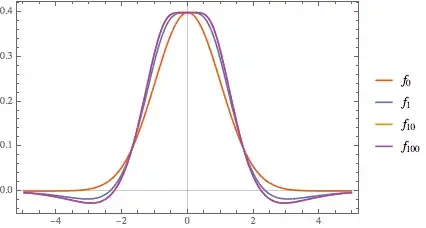

Here is some numerical evidence to the affirmative.
Let $g(x)=\exp(-x^2/2)$ be the Gaussian function such that $\mathcal Fg=g$. Let us define our function of interest as a linear combination of copies of $g$ stretched by powers of $2$ (factors in blue are mathematically superfluous but improve the numerical conditioning of the system we will form): $$f_n(x) = \sum_{i=-n}^n \color{blue}{2^{-i^2}}a_ig(2^ix).$$ By choosing $a_{-i}=2^{-i}a_i$ for negative $i$, we satisfy $\mathcal Ff_n=f_n$. We are left with $n+1$ degrees of freedom $a_0,\dots,a_n$, so we may impose $n+1$ equations: $$\begin{align} \int_{\infty}^\infty f_n(x)\,\mathrm dx &= 1, \\ \color{blue}{\frac12}\,f''(0) &= 0, \\ &\vdots \\ \color{blue}{\frac{2^{-n^2}}{(2n - 1)!!}}\,f^{(2n)}(0) &= 0. \end{align}$$ (Note that $f_n$ is an even function so all odd derivatives are automatically zero.) These equations form a linear system in the coefficients $a_i$, in fact a nearly tridiagonal one with diagonal entries converging to $\pm1$, which can be easily solved numerically. Let's look at the resulting functions:
Sure seems to be converging to something.
Here's a table of the values of $a_i$ for different $n$:
$$ \begin{array}{rcccccc} n & a_0 & a_1 & a_2 & a_3 & a_4 & a_5 \\ 0 & 0.398942 & & & & & \\ 1 & 0.626909 & -0.303956 & & & & \\ 10 & 0.729176 & -0.465597 & 0.246237 & -0.124822 & 0.0626214 & -0.0313298 \\ 100 & 0.729177 & -0.465598 & 0.246238 & -0.124825 & 0.0626265 & -0.0313400 \\ \end{array} $$
    Interesting idea! However there is one possible problem here: as I recall when I tried an expansion by means of Hermite function I got a function that looked similar to yours, but for large $n$ it degraded towards a constant function. With your Ansatz it however seems not easy to consider large $n$ since the matrices are incredibly bad conditioned. So I'm unsure whether or not the same problem will arise here. – Hyperplane Jul 10 '17 at 16:38
  • You're right, a numerical solution is uselessly inaccurate even for $n=10$; I've been computing exact solutions using a CAS. Maybe there is some structure in the equations that can be exploited to improve the conditioning, but I haven't put any thought into it. –  Jul 10 '17 at 17:55
  • I fixed the numerical conditioning problem. We still get a dense matrix of course, but it has decent conditioning ($\kappa$ is only $27.7$ for $n=100$, roughly the same as for $n=10$). –  Jul 11 '17 at 04:42
