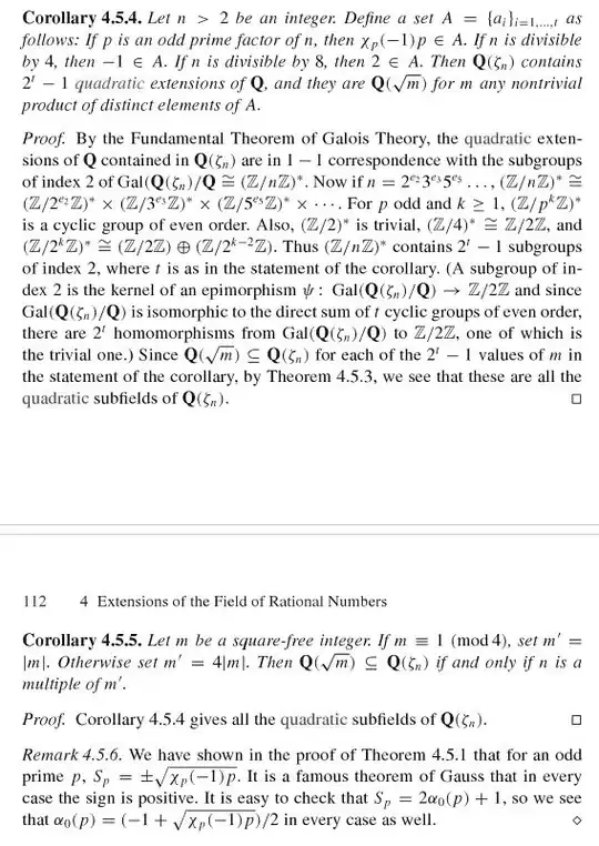

This result of Gauss is very well-known in algebraic number theory. The obvious web searches will easily locate proofs and much more, e.g. here's a proof from Weintraub: Galois Theory enter image description here
Bill Dubuque

  • many times, I read a book just "overhead"; but there are always some interesting theorems in the book, which we do not see really with beauty. You are showing such an example to me. – Groups Oct 01 '15 at 06:04
