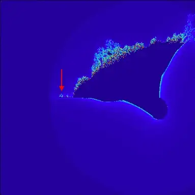

I've shown some simple representation of the Burning Ship "interesting area" below.

above: Burning Ship, $-3, -2i$ to $1, 2i$

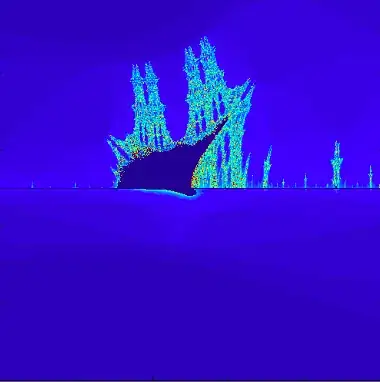

above: Burning Ship, $-1.85, -0.1i$ to $-1.65, 0.1i$ The "Radio Towers" above this and other nearby ships are generally the source of the most popular fractal image generation.

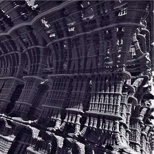

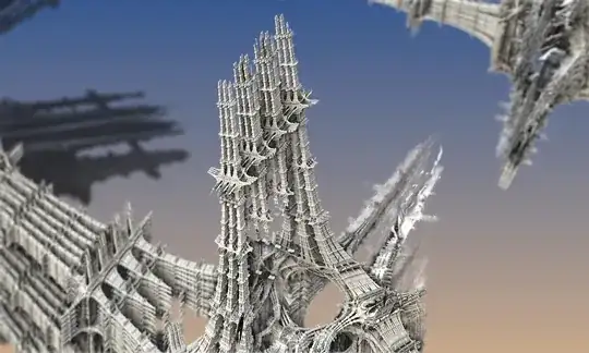

above x2: Burning Ship "3D Fractals" from here.
