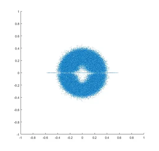

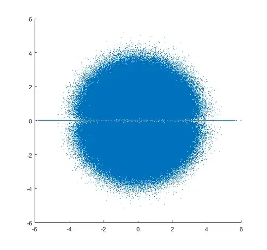

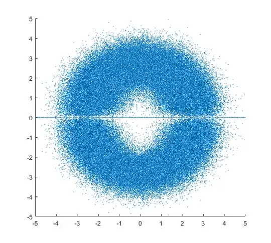

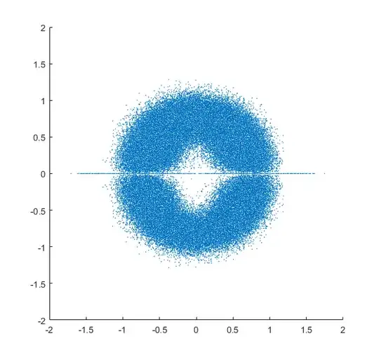

Plot the eigenvalues of many $n\times n$ real matrices in the complex plane, where the matrices are taken from a some distribution. For $n>7$, you can start to see a hole at the origin starting to form. From Girko's Circular Law I'd expect the distribution to tend toward a solid disc (with no hole in it). Below, the eigenvalue distributions of $10\times 10$ matrices taken from three distributions are seen, all with holes in them. The bigger $n$ is, the larger the hole is. The distributions are:
  1. All entries of all matrices are $\mathcal{N}(0,1)$
  2. All entries of all matrices are $\mathcal{U}(0,1)$
  3. The matrices are picked uniformly over the volume of a unit $n^2$-ball.
Is this real (and not a bug in my code)? If it is, what is this phenomenon called?
This seems to violate Girko's Circular Law, so what am I missing?
enter image description hereenter image description hereenter image description here

Have I perhaps made some stupid mistake?
2nd edit: Here is a plot with the corrected code, as requested: enter image description here
