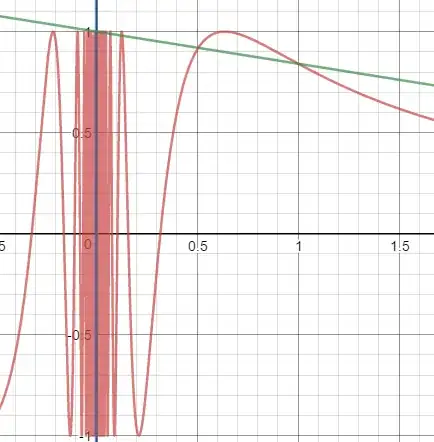

It is probably easiest to show that the point $(0, 0)$ doesn't satisfy the property of being locally path connected. The picture below shows the space in question: (ignore the left of the y-axis)enter image description here
Pick an open ball of radius $R$ about $(0,0)$ with $R$ small enough that the ball doesn't intersect the green line. Denote this $B((0,0), R)$. Given any open subset $V$ of $B((0,0), R)$ we must have an open ball of radius $r \le R$ with $B((0,0), r) \subset V$.
If we can show that these spaces are not path connected then we're done. However it is obviously the case that these spaces are not path connected. If we could join up the $\sin(1/x) \text{-space}$ to the $y$-axis by a continuous path all inside $B((0,0), r)$; then we could certainly join up simply the $\sin(1/x) \text{-space}$ to the $y$-axis not necessarily constrained to the open ball $B((0,0), r)$.
However this cannot be done (this is a standard example of non-path connected space that is a connected space - see 'topologists sine curve'). But if you need help with this just ask. Hope this helps!
