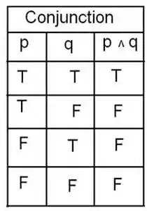

If we wanted to ignore the last two possiblities, we are then saying you pick a piece of fruit up, and it has to be an apple and it has to be delicious, because there are no other possibilities. In this case using implication no longer gives the correct truth table, so we need to use conjunction:
$$\forall{x} \in F, A(x) \land D(x)$$
Which has a truth table:
Conjunction truth table
This now matches the English statement that every piece of fruit you pick up is an apple and delicious.
