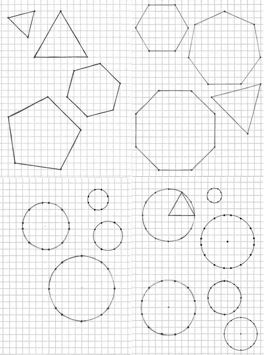

I find myself often fooling around with pen and paper, preferably squared paper. So I began looking for ways to sketch geometric figures as precisely as possible without using compass and/or ruler. In particular I'm thinking of regular polygons and circles. I'm attaching a picture of my best findings, intentionally left handmade to show the kind of result I'm pursuing (following an answer I introduced a couple of digital adjustments). Explanations follow below.
Let me start with regular polygons. The rule is simple: the vertices must lie at the grid crossings, that is their coordinates must be expressible as integer numbers. Apart from the square, it is not possible to get regular polygons with this restriction, so the intent is to obtain the closest approximations keeping the figures "small". I've explored different ways to quantitatively assess the "precision" of an approximation, starting from length uniformity of sides (satisfactory only for triangles) later combined with uniformity of angles, to the mean squared distance of vertices from the ideal ones not lying on the grid. I put no requirements about the center; should it happen to fall on or close to a crossing, even better. Moreover I tested different size factors to take into account the fact that getting better shape approximations with bigger figures is somewhat obvious and also less useful for sketching. Anyway I've found substantial agreement among different strategies. In fact, I didn't really find head-to-head confrontations whose "winner" depended on the scoring details, and even if I did I would have happily declared a tie and kept all the alternatives. So, the sheet of paper in the top-left corner of the figure collects my best results of this family.
Next I'm relaxing the restriction: I'll let the vertices fall also on the middle points of the sides of paper squares. These can be located with satisfactory precision by eye, instead I'm not going to allow center points of paper squares. This new rule is equivalent to halving all the coordinates of a valid previous solution, provided that no point had both coordinates odd (one can horizontally and/or vertically translate the original figure by $1$ before attempting the division). I might also add that I don't like to see a line running parallel to the grid cutting squares in halves, but it's just a matter of taste. Obviously, at comparable dimensions, better approximations can be found with this additional freedom, and my best findings are represented in the top-right corner.
I shall proceed to circles. They are different, in that they do not have a limited number of vertices and one can look for support points –that now can belong to the circle and lie exactly at grid intersections at the same time– with no a priori restrictions of position and amount. So the goal becomes to find as many of them, and as evenly distributed, as possible. Again I'm trying to keep the circles small, with similar considerations as before about loss of interest as size grows. With this in mind, my best circles are depicted in the bottom-left corner.
Finally, again I soften the rules: support points on the grid can be approximations of exact circle points and/or they can be placed on middle points of square sides. My best findings of this kind are those in the bottom-right corner.
I couldn't find any serious dissertation on this (indeed trivial) argument, the most closely related argument being this: Circle Lattice Points. Is anyone aware of others? Or is anybody willing to find themselves other similar (or better, under any respect) figures?
EDIT: I don't want to seem ungrateful to those who took care of my question, but I still haven't received the answer I was hoping for. The fact is that I'm looking for a way to discover whether I have "missed" some interesting figures in the described context. I exploited my (limited) programming skills to perform some automated searches, but I'm not sure that my algorithms guarantee not to miss any good solutions. I can describe and discuss these too, but I'd prefer to leave everyone free to use their original approach. Another chance would be to find some reference covering the topic, but I'm afraid that this is really too "recreational" to be dealt with in literature. Maybe something on the Internet? Someone who has done anything similar before me? I'm starting a bounty to find out! Thanks in advance!

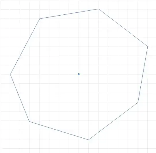

If you look at your hexagon (near the pentagon) you could consider each side to be the hypotenuse of a right triangle. If each square (from the squared paper) has side length $1$, then that hexagon has four sides of length $\sqrt{1^2+4^2}=\sqrt{17}$ and two sides of length $\sqrt{3^2+3^2}=\sqrt{18}$. Your other hexagon doesn't quite have vertices on the grid, has a couple of vertices at midpoints of "grid unit segments", so one has to double all sides to fit it on the grid. If that is done, then it has two horizontal sides of length $8=\sqrt{64}$, and four sides of length $\sqrt{4^2+7^2}=\sqrt{65}$.
So, a step (of course incomplete) would be to look for (small, integer) $a,b,p,q$ with $a^2+b^2\approx p^2+q^2$, for example $a^2+b^2=p^2+q^2\pm1$, where $a,b,p>0$ and $q≥0$. This could be done with a computer. Then, it would be a next step (which I didn't try to solve) once you find such $a,b,p,q$, try to find a right triangle with sides $a,b$ and another right triangle with sides $p,q$, and try to put them together so as to use the hypotenuses as sides of your polygon. More generally look for $a_1^2+b_1^2\approx a_2^2+b_2^2\approx...\approx a_n^2+b_n^2$ for a suitable $n$ (for example your septagon has $n=4$).
Your septagon has one point which is a midpoints of a "grid unit segment", so multiplying all sides by $2$, I get lengths (from bottom to top, squares of length of hypotenuses, rather than lengths themselves):
$10^2+0^2=100=6^2+8^2\approx104=10^2+2^2\approx97=4^2+9^2$.
This seems related to the link that you provide in the statement of your question, as well as to the link in the comment by @dantopa (about Diophantine equations), as well as to (not exactly) Pythagorean triples (but we do not look for $a^2+b^2=c^2$, only for
$a^2+b^2=$ integer $\approx$ another integer $=p^2+q^2$).

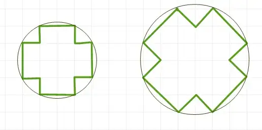

At first: idea is nice for design. My first attempt is hard and primitive, but the idea can get more successful implementation. enter image description here
And the second attempt can be more interesting, because this, as if, is the only non-convex polygon with pronounced symmetry axes, all "convex" vertices of which lie on one circle. And which can be paved with a plane.
In addition, in a vertical arrangement, it is very similar to the reward for the positive, which is present in the topic.
  • I'm not sure what you mean talking about "the reward for the positive". Yet your picture turned out to be extremely useful: at the beginning I discarded circles defined by 8 points as "too easy", but afterwards I decided to include one (not even smaller) with 6... this made no sense, so I corrected my picture. Thank you! – lesath82 May 13 '17 at 22:22
