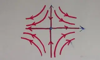

OK, following the comments of Moishe Cohen, we consider the action of $G = \mathbb{Z}$ on $X = \mathbb{R}^2 \setminus \{(0,0)\}$ given by iterating the linear transformation $\left( \begin{smallmatrix} 2 & 0 \\ 0 & \frac{1}{2}\end{smallmatrix} \right)$. The orbits of this action travel along hyperbolas, as pictured in red below.
It is pretty clear from the picture that, for fixed $v \in X$, the orbit map $n \mapsto n \cdot v$ is proper i.e. eventually escapes from any compact set (note that a compact set in $X$ needs to be bounded away from the origin).

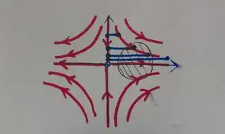

On the other hand, we also find that this is not a proper action. Consider a compact line like $L = [0,1] \times \{1\}$. The forward iterates $n \cdot L$, represented as the blue horizontal lines in the picture below, elongate and approach the positive $x$-axis as $n \to \infty$.
Thus, we see the $n \cdot L$ never escape from certain compact sets, for instance the compact disk shaded black in the above image. So, we find that the condition of being a proper action is strictly stronger than having proper orbit maps.
