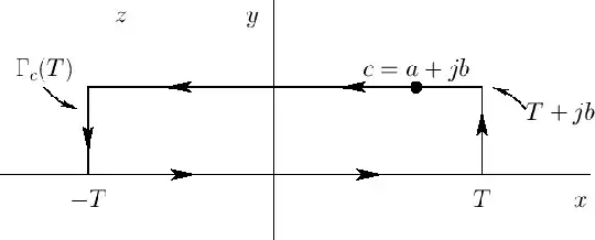

After completing the square of the exponential argument, use the following contour to justify the change of variables,
Here is what $c$ is $$\displaystyle \int_{-\infty}^\infty e^{-p(t+c)^2}dt = \sqrt{\frac{\pi}{p}}, \quad p,c\in {\bf C},\;\mathrm{Re}\displaystyle \left\{p\right\}>0$$

I don't quite understand. Could you maybe tell me what in my case would be $c$? What do I have to use as $f$ in Cauchy's formula? – studeth Oct 27 '12 at 13:09
Could I argue that the integral along this contour vanishes and as the paths left and right (in vertical direction) cancel each other, the integral along the complex path must equal the integral along the real axis and therefore for $T \to \infty$ the integral from $-\infty$ to $\infty$ equals the integral from $-i \infty$ to $i \infty$? – studeth Oct 27 '12 at 13:30

@Mercy: I mean that $\int_{-\infty+tik}^{+\infty+tik} e^{-x^2/2t} dx = \int_{-\infty}^{+\infty} e^{-x^2/2t} dx$, since the integrals over the left-hand and right-hand side of the rectangle drawn in Mhenni Benghorbal's answer vanish as $T$ goes to $\infty$. – Alexander Shamov Oct 27 '12 at 20:16
@AlexanderShamov And because the function is holomorphic and with no pole in the rectangle. – Did Oct 28 '12 at 07:52
