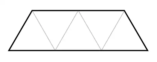

Can rotations and translations of this shape
perfectly tile some equilateral triangle?

  • The analogous tile made of three equilateral triangles can tile any equilateral triangle with side length divisible by three.

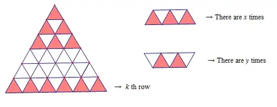

    Sorry, I didn' find anything. Lengt of a side of the big equilateral triangle is $n$. Therefore we have $n^2$ times unit equilateral triangles. In the figure, $k$-th row has $2k-1$ unit equilateral triangles. Let's paint with red color to $k$ times unit triangles and paint with white color to $k-1$ times unit triangles, in $k$-th row. enter image description here
    $x$ times part has $3$ red, $2$ white triangle. $y$ times part has $2$ red, $3$ white triangle.
    – scarface Apr 12 '17 at 01:39
    ... Number of all red triangles $$ 1+2+3+\cdots +n =\dfrac{n(n+1)}{2} $$ and number of all white triangles $$ 1+2+3+\cdots + (n-1) =\dfrac{n(n-1)}{2} $$ Hence, \begin{array}{lcl} 3x+2y & = & \dfrac{n(n+1)}{2} \ 2x+3y & = & \dfrac{n(n-1)}{2} \end{array}
    By adding these $5(x+y)=n^2$, $x+y=\dfrac{n^2}5$ and $5 \mid n$. Also we find that $x=\dfrac{n(n+5)}{10} $. But, these are not new things.
    – scarface Apr 12 '17 at 01:41

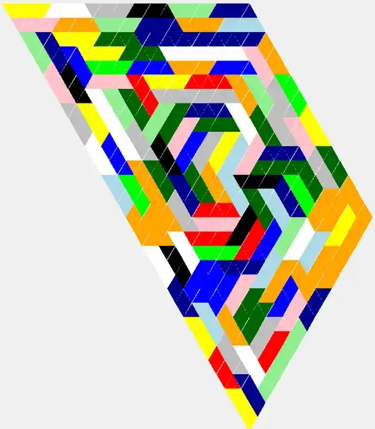

I suppose I should post: I solved this on MathOverflow. The answer is YES: a size-45 triangle can be tiled.

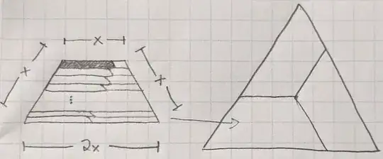

I thank two insights from Josh B here: first that a rhombus with side length 15 can be tiled, and second the strategy to "select a different shape which does tile a triangle, then tile that shape with our $5$ triangle trapezoid."
This $15-15-15-30$ trapezoid can be tiled, and three such trapezoids can tile a triangle with side length $45$.

    Thanks to you! How did you find that tiling? In the MathOverflow post you mention an SAT solver. Any more details? I had attempted this very search with BurrTools but it was going to take far too long. I think BurrTools gets in trouble when there are many ways to tile a subset of the full shape. For example, a rhombus of side length 5 can be tiled in two different ways. A parallelogram of lengths 5 and 6 can be tiled 4 ways. It only gets worse from there. – Josh B. Apr 17 '17 at 01:57
  • Thanks again. I added a picture of the solution to your answer because math.stackexchange answers are supposed to be self-contained. – Oscar Cunningham Apr 17 '17 at 07:06
  • Wonderful solution. Very entertaining how you reduced the problem to the case of three equilateral triangles. – Daniel Pietrobon Apr 17 '17 at 08:58

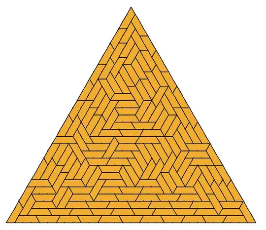

Here's the minimal solution, a side-30 triangle. Also posted to MathOverflow here https://mathoverflow.net/questions/267095/can-a-row-of-five-equilateral-triangles-tile-a-big-equilateral-triangle.enter image description here
Some people were interested in heptiamond tiling. I found that the shortest trapezoid that can be tiled has 15 rows.
enter image description here (click for larger image)
I think that this trapezoid plus parallelograms are sufficient to tile an equilateral triangle. [Edit: Nevermind, see "Tiling a triangle" below]

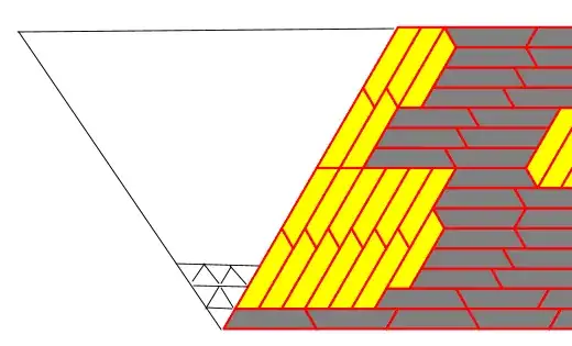

How I found this:
We start with an empty trapezoid, with 15 rows, and add heptiamonds left-to-right one at a time. We can only add a heptiamond if it doesn't leave a "gap" in any row. This way, we can represent our current state with only one number per row: the number of triangles in it.
Implicitly, our rows start with some triangles already. The bottom row has 1 triangle, the next row up has 3 triangles, then 5, 7, 9, ...
Also, we only need to keep track of the number of triangles in each row modulo 7, since we can always add a "flat" heptiamond, affecting only a single row.
So our state space has size 7^15 (~4.7 trillion).
From the starting configuration of {1,3,5,0,2,4,6,1,3,5,0,2,4,6,1} we do a breadth-first search and reach {1,1,1,1,1,1,1,1,1,1,1,1,1,1,1} -- meaning that each row has the same number of triangles (modulo 7).
Here is the progression of states corresponding to adding one yellow heptiamond at a time:

Note that each state changes exactly 4 adjacent rows. For example, the first change is {3,5,0,2} -> {5,0,2,3}. There are only 28 such transitions possible, corresponding to the 4 non-flat heptiamond orientations, at 7 possible offsets each.
Pentiamond:
The pentiamond requires 8 rows
Tiling a triangle:
Initially, I thought a 15-row trapezoid would be useful for tiling a triangle, but my initial idea didn't work. Instead, I found a 21-row trapezoid: enter image description here
This was found by doing a similar search, but switching the search space to consider only the first 15 rows. Except, when the first 6 rows are "0", only the last 15 rows are considered. (With this trick, my program could run within my machine's 16GB of memory).
These trapezoids can be stacked and padded to tile a 1-1-1-2 ratio trapezoid. 3 of these mega-trapezoids tile an equilateral triangle.
Note that it's important for the trapezoid to have 21 rows (a multiple of 7) instead of 15 rows. Then the trapezoid can be "extended" by any integer length, by appending 21x1 parallelograms.

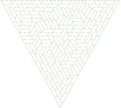

SAT-solver (glucose) + requiring rotational symmetry very quickly finds solutions for side-30. For example:
Without requiring symmetry, glucose took ~1 hour to find a solution. (Note that rotational symmetry requires side-length to be a multiple of 3 -- otherwise there is a central triangle).
