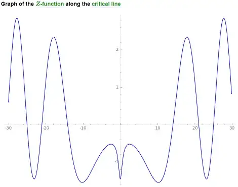

For $Re(s) > 1$ let $$\xi(s) = 2\pi^{-s/2} \Gamma(s/2) \zeta(s)=\int_0^\infty x^{s/2-1} (\theta(x)-1)dx, \qquad \theta(x) = \sum_{n=-\infty}^\infty e^{-\pi n^2 x}$$ With the Poisson summation formula we find that $\theta(1/x) = x^{1/2}\theta(x)$ and $$\xi(s) = \int_0^1+\int_1^\infty x^{s/2-1} (\theta(x)-1)dx$$ $$= \frac{1}{s-1}-\frac{1}{s}+\int_1^\infty (x^{s/2-1}+x^{(1-s)/2-1}) (\theta(x)-1)dx = \xi(1-s)$$ which is true for any $s$. Also $\xi(\overline{s}) = \overline{\xi(s)}$ so that
$Z(t) = \xi(1/2+it)$ is a function $\mathbb{R} \to \mathbb{R}$. It has a zero at every sign change. The Riemann hypothesis is that it doesn't have any other zero. Its 1st sign change is at $t \approx 14.134725$
reuns
  • 79,880
    the plotted function is $Z(t) = \frac{\xi(1/2+it)}{\pi^{-1/2} |\Gamma((1/2+it)/2)|}$ but it doesn't change anything – reuns Mar 13 '17 at 12:28

    @Alphonse You can't do better. It is believed $t_1$ is "a new mathematical constant", as $\pi,e,\gamma$.. – reuns Mar 13 '17 at 18:10
