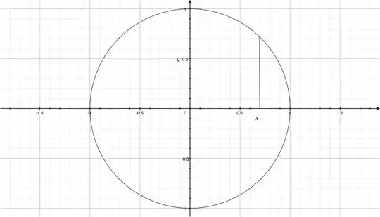

The average value of of $\sin$ over quarter its period is nothing but the average value, with respect to $\theta$, of the height of the line segment as the line segment moves from the right end point of the circle towards the origin such that it is always perpendicular to the $X$ axis, with one end point of the segment on the $X$ axis and the other end point of the segment on the circumference of the circle.
Now here comes the claim. The average value, with respect to $\theta$, of the height of the line segment times the circumference of the quarter of the circle is the area of a unit square. enter image description here

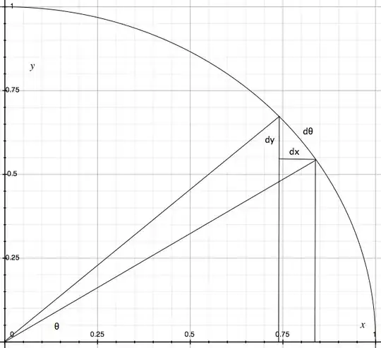

Further, for the small triangle, we have
$$\displaystyle (dx)^2 + (dy)^2 = (1 \times d \theta)^2$$ $$\displaystyle (dx)^2 + \frac{x^2}{y^2}(dx)^2 = (d \theta)^2$$ $$\displaystyle \frac{x^2 + y^2}{y^2}(dx)^2 = (d \theta)^2$$ $$\displaystyle (dx)^2 = y^2 (d \theta)^2$$
Note that as $\theta$ increases from $0$ to $\frac{\pi}{2}$, $x$ decreases from $1$ to $0$ and hence
$$\displaystyle dx = -y d \theta$$
Hence, $$\displaystyle \text{Area of square} = 1 = \int_{0}^{1} 1 \times dx = \int_{0}^{1} dx = \int_{\pi/2}^0 (-y) d \theta = \int_0^{\pi/2} y d \theta$$
Hence, $\displaystyle 1 = \int_0^{\pi/2} y d \theta = \frac{\int_0^{\pi/2} y d \theta}{\int_0^{\pi/2} d \theta} \times \int_0^{\pi/2} d \theta$
Note that $\displaystyle \int_0^{\pi/2} d \theta = \frac{\pi}{2}$ which is the circumference of the quadrant and $\displaystyle h = \frac{\int_0^{\pi/2} y d \theta}{\int_0^{\pi/2} d \theta}$ is the average value, with respect to $\theta$, of the height of the line segment.
Hence, we get $\displaystyle h \times \frac{\pi}{2} = 1$ i.e. average value, with respect to $\theta$, of the height of the line segment if $\frac{2}{\pi}$.
Hence, we get that $$\displaystyle \int_{0}^{\pi/2} \sin(\theta) d \theta = 1$$ when $\theta$ is in radians
