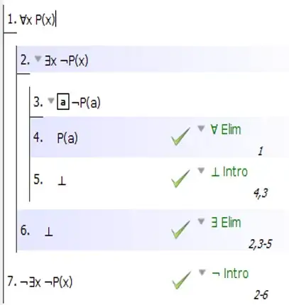

I need to prove:
$\forall x.p(x) \Rightarrow \neg \exists x.\neg p(x)$
I know I probably have to assume $\exists x.\neg p(x)$ to reach a contradiction. However, I am not quite sure about how to reach the contradiction.
The premise is that $\forall x.p(x)$, so maybe I had to prove $\exists x.\neg p(x) \Rightarrow \neg \forall x.p(x)$ in this case. However, to get $\neg \forall x.p(x)$ required assuming $\forall x.p(x)$ in advance, which is the same as the premise. Is it feasible? Whether such scenario would cause a endless loop?
I am not sure how could I get a contradiction for this case, any help would be appreciated, thanks!

Different systems define the Existential Elimination (or Existential Instantiation) differently, but here is a proof in the Fitch system I use:

Bram28
  • 103,721
  • I'm sorry that I'm not familiar with your system's notation. Is step 3 equivalent to $\forall a \neg P(a)$? – Han Feb 25 '17 at 05:41
  • @Han Yeah, I was afraid your system might be different ... How is your Existential Elimination rule defined? ... And no, you don't want to use $\forall a \neg P(a)$, since $a$ is a constant, and you can only quantify over variables. – Bram28 Feb 25 '17 at 13:32

  • @Han Huh! I must say, I have never seen such an implementation of EE! But you're right, it does indeed require a universal! Well, OK, no worries, my proof can easily be modified to fit your format.: On line 6, use $\forall : I$ On the subproof to get $\forall x (\neg P(x) \rightarrow \bot)$. Then on line 7, use EE on lines 2 and 6 to get $\bot$. And line 8 will be like the original line 7. – Bram28 Feb 26 '17 at 02:51
  • @Han Oh, wait, their universal Introduction rule is different as well from how I use it. ... OK, let me just edit my Answer. Give me 10 minutes or so... – Bram28 Feb 26 '17 at 02:59
  • Thank your for your kindly help these days. I understood all your steps and I thought your solution is reasonable enough, however, because of the difference of Fitch System, I am still struggling with this problem... – Han Feb 26 '17 at 05:07
  • @Han Do you have the contradiction ($\bot$)? And can you maybe send me a link to the propositional logic rules? – Bram28 Feb 26 '17 at 05:10
  • We do not have the contradiction symbol, yeah, that's the main part that I was stuck. I think most of the rules can be checked with this url: http://logic.stanford.edu/intrologic/glossary/glossary.html. It seemed that rules about $\forall$ and $\exists$ were excluded, both of them can be seem from here: http://logic.stanford.edu/intrologic/notes/chapter_08.html – Han Feb 26 '17 at 05:38
  • @Han Oh boy! They're not making this easy, do they?! Anyway, let me modify my proof yet again! – Bram28 Feb 26 '17 at 06:10
  • @Bram28, yeah, this might be the hardest one for this problem set. I don't know why the discussion forum was removed, and I was stuck almost a week or so... – Han Feb 26 '17 at 08:12
  • @Bram28: You may be interested to know that it is easiest to use such an existential elimination rule to represent Fitch-style natural deduction in a sequent calculus like in this post. I also found a very very brief summary of many ND systems at http://ualberta.ca/~francisp/papers/pelletierNDtexts.pdf – user21820 Feb 26 '17 at 08:26
  • @Han Holy cow! I got it, but that was a major pain!! What a sadistic system of rules. :( That EE rule requiring you to have a universal makes for quite roundabout proofs, and the same goes for not having an explicit $\bot$ and associated rules. Look how much easier this is in the system I use.... Oh well! – Bram28 Feb 26 '17 at 14:22
