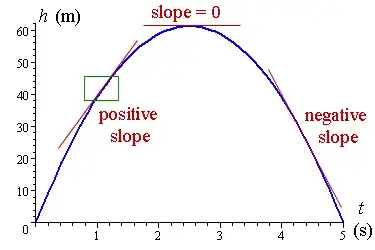

Now let's talk about the way you should think about the derivative of a function. The derivative of a function tries to say how much the value of the function changes when you change the input by a tiny amount - and you'll consider the ratio of the change, in the same way as you'd consider a percentage change. In particular, you might want to know how much $x^2$ changes when you move from $x=2$ to $x=2.01$, for instance. Another way of thinking about this is the tangent line to the function at a point, so we might want to know what the slope of the tangent to $y=x^2$ is when $x=2$, and it doesn't take much thought to see why these are both the same idea. To look at the tangent line, it makes sense to instead consider the point $(2, 2^2)$ and another point really close to it, say $(2.01, 2.01^2)$, or $(2.0001, 2.0001^2)$, or $(2+h, (2+h)^2)$, where $h$ is really close to $0$ (possibly negative), and look at what the slope of the line connecting these two is for tiny $h$. This starts to look like the definition of the derivative, because the slope of the line connecting $(2+h, (2+h)^2)$ and $(2, 2^2)$ is $$\frac{(2+h)^2 - 2^2}{2+h-2} = \frac{(2+h)^2 - 2^2}{h}$$
and just like above, you can compute the limit of this expression to be $4$.
This easily generalises to any point $x$ (instead of $2$), and to any (differentiable) function (instead of $x^2$), to give a limit as defined above.
It's important to realise that the derivative is another function in itself, and the meaning of $f'(x) = 2x$ is that at the point $t$, the slope of the tangent line to $y=f(x)$ at $t$ is $2t$.
