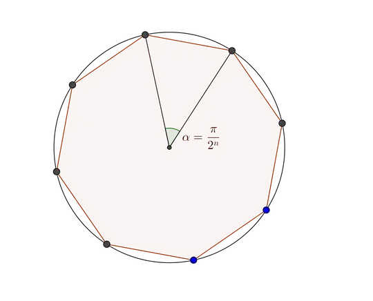

I think one way to prove it would be to deal with regular polygons inside a circle and play the angles and trigonometry.
Do you think it would work?
Is there a different way to proceed?
