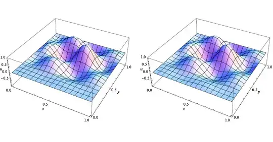

For example, the picture below shows (left) the surface $$f(x,y)=30x y^2 (1-x)(1-y)\cos(10x)\cos(10y), \quad 0<x<1,\ 0<y<1,$$ and a plot of the two dimensional Fourier sine series (right) of $f(x,y)$ for $n,m,=1,\dots,5$:

  • This representation seems to be valid only if the values of the function on the boundary of the rectangle are zero. – Beni Bogosel Nov 13 '13 at 11:59
  • Yes, that's why I said, "As a specific example..." The sine functions used there are the eigenfunctions obtained when solving the heat equation on a rectangle where zero boundary conditions are specified. – JohnD Nov 14 '13 at 00:47
    What about the case where cosine terms are required? This answer is useless because it does not address the general case. – user3728501 Dec 21 '13 at 14:19
    @JohnD I know this is very old, but can you add a more general representation which is not restricted to the function having Dirichlet conditions on the boundaries. Should I ask a separate question ? – Avrana Jun 08 '20 at 06:42
    @Avrana You can add a phase for x and y, and also add a rotation, to get a more general expression. – user877329 Oct 28 '23 at 07:45
