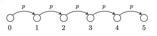

Imagine we have six nodes, labeled 0 through 5. One can transition from node $i$ to $i+1$ with probability $p$ or can remain at node $i$ with probability $1-p$. Note that once one transitions to a node, it cannot backtrack. See the following figure for an illustration.
I want to know the expected time it takes to reach node 5 assuming you start at node 0. I started to write down the following outcomes below:
  • 5 transitions, 0 stops (5 time-steps)
  • 5 transitions, 1 stop (6 time-steps)
  • 5 transitions, 2 stops (7 time-steps)
  • and so on...
where "stop" means no transition was made. Once we list all of the cases then it's just a matter of computing the probabilities. Problem is, I don't know how to write out all of the cases (infinitely many?). Is this the right way of thinking about it?

    The expected number of moves to go to the next state is $1/p$. So you need on average $5/p$ moves to go from 0 to 5. – msm Jan 12 '17 at 03:11
  • Thank you. If we write out the cases, does the following hold: $5p^5+6p^5(1-p)+7p^5(1-p)^2 + 8p^5(1-p)^3+\cdots = 5/p$? – jonem Jan 12 '17 at 03:21
  • I am not sure if that series is right ( shouldn't $5p^5$ be $p^5$?), but yes. You can write it as a powered series representing all possible cases. – msm Jan 12 '17 at 03:28
  • If you want more details, let $E$ be the expected time for transition from a state to a higher state. Since with probability $1-p$ we need one more move $$E=p+(1-p)(E+1)\implies pE=1\implies E=\frac{1}{p}$$ – msm Jan 12 '17 at 03:35
Let $T_i$ be the time it takes to reach node $i$ for $i = 1, ..., 5$.
Then the total time $T$ it takes for one to reach node 6 from node 0 can be written as a sum \begin{align*} T = T_1 + \dots + T_5 \end{align*} So the expected value of $T$ is \begin{align*} ET = \sum_1^5 ET_i \stackrel{(*)}{=} \sum_1^5 \frac{1}{p} = \frac{5}{p} \end{align*}
$(*)$ Since each $T_i$ is distributed $\sim$ Geom($p$)

The easier way to approach this problem is to take advantage of linearity of expectation by expressing the transit time as a sum of i.i.d. geometrically-distributed random variables, as in Daniel Xiang’s answer, but it can certainly be attacked the way you propose: by computing the probability that it takes a given number of time steps to reach the end and then finding the sum of the infinite series that directly results from the definition of expectation.
Let $Y$ count the number of time steps to transit the chain. Since every transit takes at least five steps, we’ll focus on the probabilities of extra time being taken—of there being $k$ stops during the transit. Let the random variable $X=Y-5$ count these extra steps. As you’ve already determined, $\Pr(X=k)$ is equal to $p^5(1-p)^k$ times a coefficient that counts the number of ways that the stops can be distributed throughout the transit. This is a typical stars-and-bars problem, from which we can easily work out this coefficient: $$\Pr(X=k)=\binom{4+k}4p^5(1-p)^k$$ so $$E[X]=\sum_{k=0}^\infty k\Pr(X=k)=p^5\sum_{k=0}^\infty k\binom{4+k}4(1-p)^k=p^5{5-5p\over p^6}=5{1-p\over p}$$ and $$E[Y]=5+E[X]=\frac5p.$$
amd
  • 55,082
You can model the number of steps to reach the destination as a Negative Binomial random variable $X$ with parameters $r=5$ (number of successes) and $p$. The success is moving to the right (with probability $p$ and the failure is staying in the same position.
The expectation of a Negative Binomial random variable is:
$$E[X]=\frac{r}{p}=\frac{5}{p}$$
