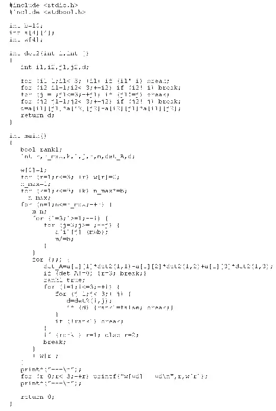

Ok, I wrote a brute force program to compute the ranks for each of the $10^9$ possible $3\times3$ matrices with integer entries between $0$ and $9$ inclusive. The run time was only $2$ minutes. Here are the counts: \begin{align} &\text{rank }0\text{ :}\;\;1\\ &\text{rank }1\text{ :}\;\;16\text{,}461\\ &\text{rank }2\text{ :}\;\;19\text{,}929\text{,}402\\ &\text{rank }3\text{ :}\;\;980\text{,}054\text{,}136\\ \end{align}
As requested, here is the program I wrote to get the counts. Nothing clever here, and no attempt at optimization -- just a brute force search.

  • @quasi Hey, quasi. Would it be possible for you to attach to the answer the code which produced these results ? Then I would accept the answer, probably, as it is visible, there are no other methods than just computational programs.. – Widawensen Jan 16 '17 at 16:01
  • @Widawensen -- I couldn't find a way to post the code as text (too many lines for MSE, I think), so I posted it as an image. – quasi Jan 17 '17 at 02:55
  • @quasi It's ok. Thank you very much that you have found the way. The code is completely comprehensible. – Widawensen Jan 17 '17 at 07:22
