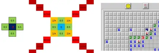

Rationale behind the solution: Laplacian Minesweeping with a Faraday Shield
As already noted, from the subset of trivial solutions, combined with the harmonicity of $A(m,n)$, all other values can be calculated, like a game of minesweeper:

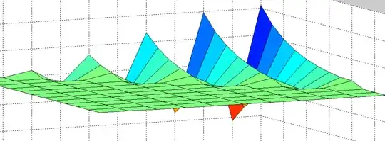

Laplacian filter and subset of solutions

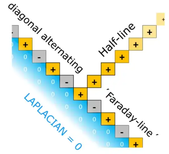

Sweeping all solutions from the trivial ones, and the Laplacian filter
Now it is illustrative to decompose the subset of trivial solutions as follows:
decomposition of the trivial solutions
It turns out that only the multiples of $\frac{1}{2}$ are responsible for the Laplacian being 1 at $(0,0)$, and zero elsewhere. The diagonal elements involving the factors of $\frac{2}{\pi}$ will with the Laplacian filter all cancel to $0$.
The decomposition into the values $\{\frac{2}{\pi},\frac{8}{3\pi}, \frac{23}{15\pi},... \}$ can be continued by decomposing them in four diagonal, infinite halflines (see image below). Now the only way the Laplacian of a diagonal half-line can be zero, is that it ends in a perpendicular diagonal of alternating values (this can be easily verified):
Alternating diagonal acting like a Faraday Shield
Alternating diagonal acting like a 'Faraday Shield'
Behind this 'Faraday'-diagonal, we need a second alternating diagonal, to compensate for the first one. The main difference, is that its amplitude must increase linearly to both sides:

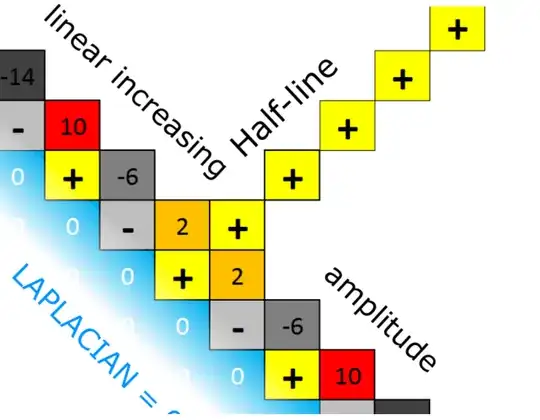

The second Faraday line with linear increasing amplitude
Second Faraday diagonal with linear increasing amplitude
In turn, this second diagonal must be compensated by a third diagonal, whose amplitude increases quadratically, and so on...
The diagonal alternating patterns with increasing amplitude
The diagonal alternating patterns with increasing amplitude (magnitude-scaled)
Once this idea is clear, it is easy to see that the needed polynomials describing the amplitudes of the oscillations, must be each others anti-derivatives. More precisely: each higher order polynomial is a weighted sum of the anti-derivatives of lower order polynomials as given above.
With a similar argument, we can also show that the four sides of the central diamond of halves are continued by infinite 'Faraday-lines'. Also these lead to higher order oscillations, which can be described by the same set of polynomials.

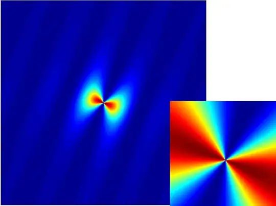

Numerical validation
I validated the integral numerically for several values of $(m,n)$ on a grid of $2^{13} \times 2^{13}$ gridpoints.
Periodic function on the integration domain
Image of the function $\frac{1-\cos(mx+ny)}{2-(\cos x + \cos y)}$ as evaluated in the numerical validation

N = 2^9;
[x,y] = meshgrid(2*pi*(-N/2:N/2-1)/N);
f = 1/(2*pi)^2*(1 - cos(m*x + n*y))./(2 - cos(x) - cos(y));
f(N/2+1,N/2+1) =  1/(2*pi)^2*(n^2 + m^2);
% compensate for discrete grid
f(N/2+1,N/2+1) = f(N/2+1,N/2+1)/2;
figure; imagesc(f); axis equal tight;
Anm_numerical = sum(f(:))/N^2*4*pi^2

Approach
I will show that when $R=1$ the resulting discrete scalar distribution:
$$ A(m,n) = \frac{1}{4 \pi^2}\int_{-\pi}^{\pi}\int_{-\pi}^{\pi} \frac{1-\cos(mx+ny)}{2-(\cos x + \cos y)} dx dy $$
is harmonic everywhere except when $(m,n)=(0,0)$. (In fact, $A (m,n)$ is the inverse operator of the Discrete Laplacian). This allows us to find all integrals with recursion, once the simple forms are calculated.
The discrete Laplacian
Let:
$$ g(m,n) = \frac{1-\cos(mx+ny)}{2-(\cos x + \cos y)} $$
Then the Discrete Laplacian of $g(m,n)$ in the $(m,n)$ domain is:
$$ \begin{align} \mathbf{D}^2_{mn} \otimes g(m,n) &=\begin{bmatrix}0 & \frac 1 2 & 0\\ \frac 1 2 & -2 & \frac 1 2\\0 & \frac 1 2 & 0\end{bmatrix} \otimes g(m,n) \\ & = \cos(mx+ny) \end{align}$$
This is not to hard to proof: Wolfram alpha
Harmonicity
Now define:
$$ \begin{align} I(m,n) &\equiv \mathbf{D}^2_{mn} \otimes A (m,n) \\&=\mathbf{D}^2_{mn} \otimes \frac{1}{4 \pi^2}\int_{-\pi}^{\pi}\int_{-\pi}^{\pi} g(m,n)dx dy \\ & = \frac{1}{4 \pi^2}\int_{-\pi}^{\pi}\int_{-\pi}^{\pi} \cos(mx+ny) dx dy \\ &= \mathcal{F}(1)\\ &= {\begin{cases} 1 & \text {if $(m,n)=(0,0)$} \\ 0 & \text{otherwise} \\ \end{cases}} \end{align} $$
which is the identity operator for convolution. This means that for each pair of integers $(m,n) \neq (0,0)$ the integral is the average of the four integrals of its direct neighbors $\{(m-1,n), (m+1,n), (m,n-1), (m,n+1)\}$.
Startvalues
It is easy to see that for $(m,n) = (0,0)$ the integral is zero. For the four direct neigbors $m^2 + n^2 = 1$, the integral must be $\frac 12$, because the Laplacian at $(0,0)$ is one, and because of symmetry.
Together with the integral derived for $m=m$ in the answer of Sangchul we have enough initial values to recursively find the other integrals:
$$ \frac{1}{4 \pi^2}\int_{-\pi}^{\pi}\int_{-\pi}^{\pi} g(m,n) dx dy = {\begin{cases} 0 & \text {if $(m,n)=(0,0)$} \\ 0.5 & \text {if $ m^2+n^2 = 1$} \\ \sum_{k=1}^m \frac {2} {\pi(2 k - 1)} & \text {if $ m=n$} \\ \end{cases}} $$
Recursive recipe:
If $n \neq m$, assume that $n>m$ (symmetry) then:
$$A(m,n) = 4*A(m,n-1) - (A(m-1,n-1) + A(m+1,n-1) + A(m,n-2)) $$
$\blacksquare$
