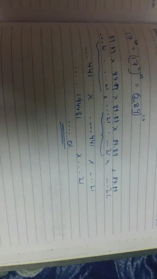

My attempt is in this image. But I want the answer to this question by using modulo congruence method since the method used by me involves tedious calculations.
$01$ is the right answer – Dr. Sonnhard Graubner Jan 08 '17 at 07:58
I know that. I told I want the solution using modulo operator. – Yami Kanashi Jan 08 '17 at 07:59
1You can search the questions on MSE for a dozen of similar questions. – Jan 08 '17 at 08:00
Is MSE maths Stack exchange? – Yami Kanashi Jan 08 '17 at 08:01
