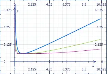

A tentative explanation:
As Newton's iterations converge to the same root, starting from many initial values, the function that associates the initial value to the iterate is very "flat".
Her is an illustration with the square root function:
As the expression of the iterates is a rational fraction, the degree of the numerator and denominator must increase to achieve this flatness. I have no explanation why the number of terms increases, though.
1I don't think this is such a great explanation because this property is just not present in a lot of other cases. It is in some sense true if, say, your function is monotone on a neighborhood of the root and you consider initial values on that neighborhood. But Newton's method can potentially have very wild dynamics in the presence of multiple extrema. – Ian Jan 06 '17 at 18:42
@ian: on the opposite, this reinforces the explanation. In case of multiple roots, the iterates can converge to a piecewise constant function (sometimes extremely complicated), something hard to achieve with rational functions, and consuming more and more degrees of freedom. Thanks for the tip. – Jan 06 '17 at 19:26
