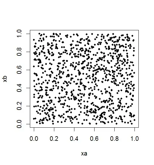

3) Look at 2-D plots. If you have a sequence of 1000 numbers $X_1, \dots, X_{1000},$ you can plot the vector $(X_1, \dots, X_{999})$ against $(X_2, \dots, X_{1000}).$ The points should 'fill' the unit square uniformly and with no noticeable pattern.
 xa = x[1:999];  xb = x[2:1000]
 plot(xa, xb, pch=20)

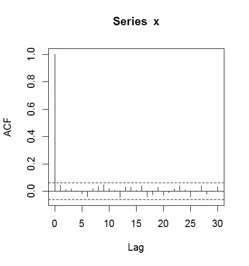

You also want the numbers to be free of patterns in higher dimensions. One method to check for certain kinds of patterns in higher dimensions is the 'autocorrelation plot', which should show no significant autocorrelations with various lags. [Vectors xa and xb above are lagged by one index.] For the vector x generated in R, there no lags up to 30 with significant autocorrelations (straying beyond the dotted boundaries in the plot). The line at the far left is for lag-0 and so has correlation $r=1.$
acf(x)
