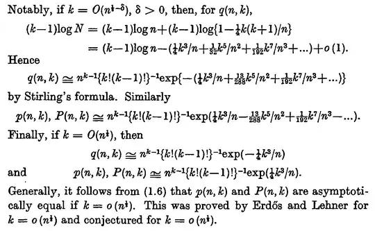

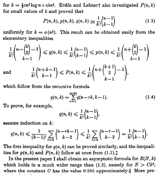

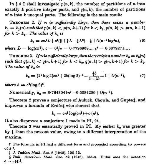

If $K$ is fixed, yes. The paper An Asymptotic Formula in the Theory of Partitions by G Szekeres states both an upper and lower bound using the notation "$q(n,k)$, the number of partitions of $n$ into exactly $k$ positive unequal parts." enter image description here
If $K$ grows with $n$, then no. The same paper goes on to describe the case where $K$ is allowed to grow with $n$ up to $K = O(\sqrt{n})$.
And in a follow-up paper, Some Asymptotic Formulae in the Theory of Partitions (II) by G. Szekeres, he identifies the $K$ which maximizes $q(n, K)$ asymptotically as $n$ tends to infinity.
