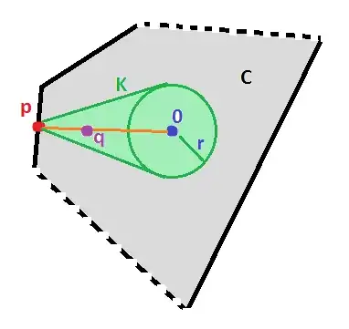

Let $C$ be your convex set, and assume without loss of generality(1) that it contains zero as an interior point and is bounded.

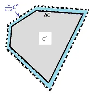

The question boils down to showing that $\partial C$ has measure zero(2), which can be shown by squeezing the boundary between the interior $C^\circ$, and a slightly expanded version of the interior, $\frac{1}{1-\epsilon}C^\circ$.
Let $p \in \partial C$. Since $0$ is an interior point, by convexity the point $q:=(1-\epsilon)p$ lies in the interior of the cone $K:=\{sp + (1-s)x: x \in B_r(0) \}$, and therefore $q \in C^\circ$. But then $p=\frac{1}{1-\epsilon}q \in \frac{1}{1-\epsilon}C^\circ$. enter image description here
Thus $$\partial C \subset \frac{1}{1-\epsilon}C^\circ.$$ Since for any set the boundary and the interior are disjoint, $$\partial C \subset \frac{1}{1-\epsilon}C^\circ \setminus C^\circ.$$ Since the interior of a convex set is convex(3) and $C^\circ$ contains zero, $C^\circ$ is contained in it's dilation: $$C^\circ \subset \frac{1}{1-\epsilon}C^\circ.$$
Finally, since we have assumed $C^\circ$ is bounded, the measure of the boundary, $$\lambda(\partial C) \le \lambda(\frac{1}{1-\epsilon}C^\circ \setminus C^\circ) = (\frac{1}{1-\epsilon})^n\lambda(C^\circ)-\lambda(C^\circ),$$ can be made as small as desired by taking $\epsilon \rightarrow 0$.
