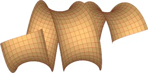

It's also not difficult to show that one-parameter families of pasta surfaces of constant Gaussian curvature exist, analogous to the one-parameter families of surfaces of rotation having constant Gaussian curvature. (For studying Gaussian curvature, it's particularly convenient to arrange that $EG \equiv 1$, i.e., that $E(u) = 1/G(u)$. The Gaussian curvature in these "momentum" coordinates is linear in the metric components: $K = -\frac{1}{2}G''(u)$.) The only complete, embedded examples are spheres, cylinders, and planes, but examples based on the pseudosphere give isometric embeddings of arbitrarily large hyperbolic disks.
(I've never looked at constant mean curvature, but don't expect obstructions to existence.)

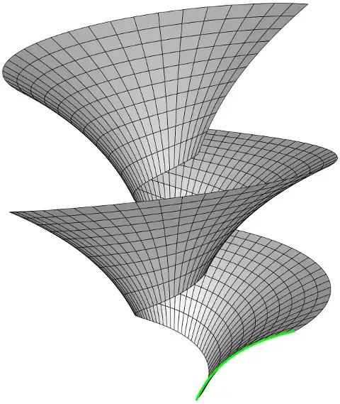

Edit of December 26, 2016: Up to a rigid motion of Euclidean three-space, every self-sliding surface (other than a generalized cylinder) arises as follows.
Fix a parametric curve $\gamma(u) = (r(u), 0, z(u))$ whose image lies in the half-plane $x > 0$, $y = 0$ and whose velocity is non-vanishing; a real number $k$ (the "pitch" or "slope" of a helix); and an arbitrary smooth function $\psi$ (the "gauge"); and put $$ X(u, v) = \left[\begin{array}{@{}c@{}} r(u) \cos(v + \psi(u)) \\ r(u) \sin(v + \psi(u)) \\ z(u) + k(v + \psi(u)) \\ \end{array}\right]. $$ The image of $X$ is the result of sliding the image of $\gamma$ (the green curve below) under the action $$ (x, y, z) \mapsto (x\cos t - y\sin t, x\sin t + y\cos t, kt) $$ of the additive group of real numbers. This action represents rotation about the $z$-axis if $k = 0$ and helical motion about the $z$-axis if $k \neq 0$. (Formally, translation along the $z$-axis arises by letting $k \to \infty$, but I assume you're mostly interested in helical motions.)
A self-sliding surface and a generator
(The gauge function $\psi$ does not change the surface geometrically, but "deforms" the $u$-coordinate curves "internally" by sliding them along the $v$-coordinates curves (circles or helices). If $\psi \equiv 0$, the $u$-coordinates curves ($v$ constant) are plane curves, the images of $\gamma$ under the group action. For some purposes it's more convenient to choose $\psi$ so that the $u$- and $v$-coordinate curves are pointwise orthogonal, as in the diagram below.)
A hyperbolic surface with helical symmetry

    Dini's surface would probably be another interesting example of a constant GC surface that can move helically. – J. M. ain't a mathematician Dec 27 '16 at 20:46

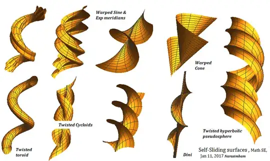

Any arbitrary meridian of a surface of revolution contained in the plane of the axis can be twisted with a screw motion, to obtain these sliding surfaces.
It has a proportionality constant between $\theta$ rotation and $z$ axial progression. We need to simply add one $ h \cdot \theta $ term to the z-coordinate.
Constant Gauss curvature K surfaces are only interesting as, before and after twist, new $K$ comes out a different constant. But it is not otherwise relevant in general imho for this question of OP.
My best guess is that
1) They are Helical Canal surfaces ( not standard nomenclature, we may prepend "general" to it, or const. negative curvature helicoids or Hwang Helicoids ) created by motion of a rigid canal cross section along a helix in which each point describes a helix with constant radial parameter $u$ and variable parameter $\theta$ or arc.
$$ (f(u) \cos v, f(u) \sin v, \, g(u) + h \cdot v) $$
The bi-normal parametrization however does not have much of an advantage over the meridional section definition; in any case the two parametrizations are equivalent.
2) Along parametric lines screw motion all curvatures $ k_n, k_g, K$ are identical.
3) Tangent vector has a constant magnitude (speed) and constant inclination to a fixed direction, here z-axis. Hence $\dfrac{dr}{dz} = \cos \phi \cos \psi = \cos \alpha $ = constant inclination of swept parameter line tangent, to symmetry axis just as it is for a single sheet hyperboloid... Cannot prove this now, although it is necessary and sufficient for this class of surfaces.
4) Parametric lines cut orthogonally,$F=0$.
5) Rotationally symmetric cases are trivial.
A number of meridians are twisted in this manner and their warping effects shown below.
Twisted/Warped/Screw Motion Surfaces
Mathematica program lists meridians chosen and the effect of $ h\cdot \theta $ term.
Clear[X, Z, u, v]; R = 2; r = 1; (* Arbitrary Meridian Screw Motion *)
X[u_] = R Sin[u];
Z[u_] = -R (Cos[u] + Log[Tan[u/2]]); (* Dini with (graphics error) *)
X[u_] = r (u - Sin[u]); Z[u_] = r (1 - Cos[u]);(* Cycloid Axes Interchanged *)
X[u_] = r (1 - Cos[u]); Z[u_] = r (u - Sin[u]); (* Cycloid  *)
X[u_] = (r Cos[u] + R); Z[u_] = r Sin[u]; (* Toroid  *)
X[u_] = (-r u + 2 R); Z[u_] = 2 r - R u;(* Cone *)
X[u_] = Exp[-u/2]; Z[u_] = u;(* Exponential curve *)
X[u_] = Sin[ 2 u] + 3 ; Z[u_] = u; (* Sine curve *)
X[u_] = Sin[ 2 u] + 2 ; Z[u_] = Cos[3 u]; (* Lissajou curve *)
ParametricPlot[{Z[u], X[u]}, {u, -Pi, Pi  },
 PlotLabel -> "PRE-TWIST MERIDIAN"]
h = 0; ParametricPlot3D[{X[u] Cos[v], Z[u] + 0 h v,
  X[u] Sin[v]}, {u, -Pi, Pi}, {v, 0, 3 Pi},
 PlotLabel -> " MERIDIAN SWEPT AROUND Z-AXIS"]
h = 1.5; ParametricPlot3D[{X[u] Cos[v], Z[u] + h v,
  X[u] Sin[v]}, {u, -Pi, Pi}, {v, 0, 3 Pi}, Boxed -> False,
 Axes -> None, PlotLabel -> "POST-TWIST ( h v) REVOLVED MERIDIAN"]
Mechanical fabrication may be also interesting. In a metal cutting machine-shop when meridian shape is supplied in the form of a template mounted on the carriage of a lathe, the operator sets $h$ value from feed/speed ratio forming the needed helix angle to produce helically slidable matching bolt and nut machined surfaces imparting a screw motion to cutting tool. The template block edge holding canal boundary profile has a constant angle to the axis of rotation.
