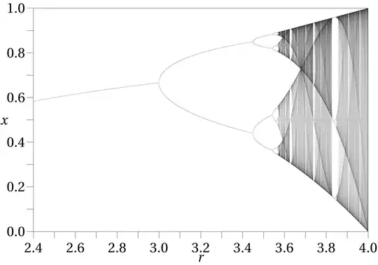

For instance, the most famous case is the Logistic map, which is very useful to understand the basic concepts of the discrete-time maps:$$x_{n+1}=r \cdot x_n(1-x_n)$$
Where you can decide the initial condition $x_0$ of the system and you can decide the value of the control parameter $r$. Depending on the value of $r$ you will arrive to different stable $n$-orbit solutions. So some of them will arrive depending on the value of $r$ to a $2$-orbit cycle, $3$, $4$, many... or you never arrive to one, which is also possible depending on the definition of the dynamical system.
To see the whole picture of what happens when $r$ changes, you can study the bifurcation diagrams. They basically represent a graph in which the $x$-axis is one of the control parameters and in the $y$-axis you put the value of the $n$-orbit points where the specific $r$ case arrive. This leads to a graph where you can study the evolution of the system depending on the value of $r$. E.g. here is the bifurcation diagram of the Logistic map (credits to Wikipedia):
