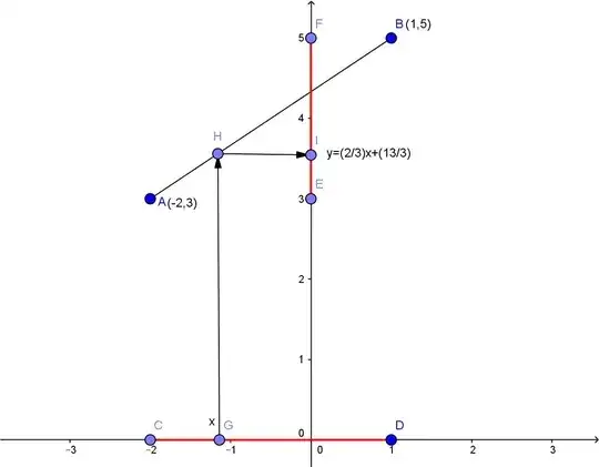

Here is a function that maps open set $(-2,1)$ onto open set $(3,5)$ which is a different issue. When I realized that I was on a different problem, I wanted to erase this "answer". But the adequate answer by @RSerrao uses mine as a step. Therefore, I leave it...
On the graphics below, have a look at the red intervals: one is $(-2,1)$ on $x$ axis, the other is $(3,5)$ on $y$ axis. The correspondence between them is an affine equation ($y=ax+b$), precisely:
$$\tag{1}y=(2/3)x+(13/3).$$
It can be explained by a kind of "mirror reflecting": the ray (vector $GH$) coming from $x \in (-2,1)$ is "reflected" into the straight line $HI$ with impact in a certain $y \in (3,5)$ that can be computed with formula $(1).$
- 88,997
